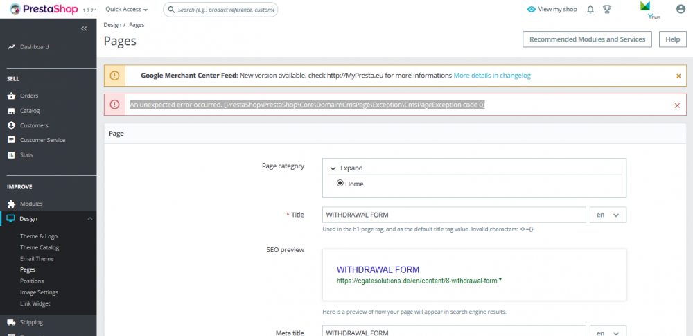

Hi there,
I checked and 1 and 2 are ok is not my problem... 3 would be same if my code error is 0 instead of 2?
The problem is when we change the customer password in admin panel.
thank you

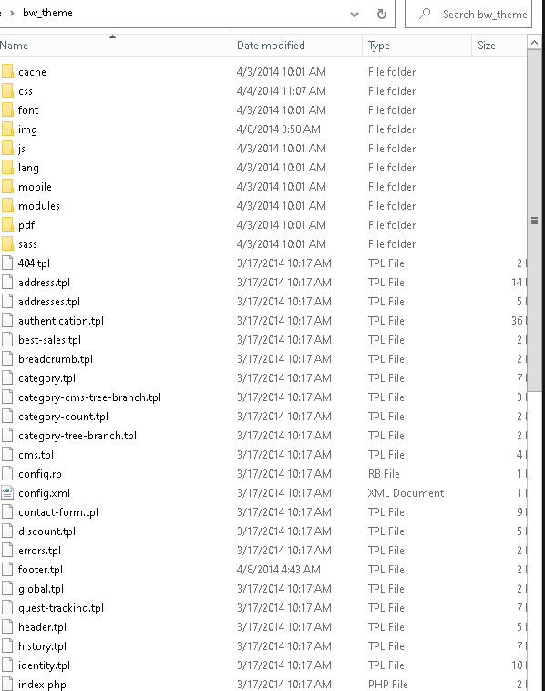

I am receiving this :
An unexpected error occurred. [PrestaShop\PrestaShop\Core\Domain\Theme\Exception\ThemeConstraintException code 2]
The error is occurring whether I am importing the file from my computer or from FTP.
Noting this is the first time (new shop) I've attempted to add a theme.
I've added as an attachment, the folder layout of the zip file I am uploading.
On 10/13/2020 at 5:27 PM, LightSakura said:
Hi there,
thank you
I'm not sure what your problem is. The issue I mentioned is causing when you change the theme. If you get it while changing admin password, that's something else. Maybe you can solve it by upgrading to the latest version.
Well it looks like your theme is for PrestaShop 1.6 based on the structure in the attached image. You cannot install any PS1.6 themes on PS1.7 since the theme structures are completely different on these versions.
7 minutes ago, Ob3yDesire said:
Thank you for the response, can I please clarify (example ideally) of a PS 1.7 template layout?   So I make sure I am testing correctly.
One easy way to find out, is to check the theme config file. In PS1.6 the config file is in "themename/config.xml" path and in PS1.7 the config file is inside "themename/config/theme.yml" path.
Also, you can check the compatible versions inside config files as well.

On 3/25/2020 at 9:53 AM, Mehrshad Zakerian said:
Hello guys,
I see that lots of PrestaShop 1.7 users are facing this issue. It may have different  reasons:
  1. As mention earlier, the "config.yml" file or folder might be missing. Go to your theme zip file, check if there's a folder called "config", a file called "config.yml" should be inside this folder. If you don't see the config folder or config.yml file, you may need to contact theme developer.
  2. The other reason might be multiple-zip-files inside each other. Sometimes your theme ZIP file contains other zip files for different PS versions or etc. If so, you need to extract it and upload the correct one. The correct zip file should contain the main theme files and folders like "assets, config, dependecies,...".
  3. A bug in PrestaShop 1.7 with ZIP files! Yes there's an issue (check here) in PrestaShop (at the time I'm writing this post, the latest version is PS 1.7.6.4) with ZIP files. You may check your theme zip file and see there is no problem with the config file or folder and there are no other zip files inside your theme zip file as well but you still get this error.
    A lot of theme developers use Windows for their development workspace and do their development using XAMPP or WAMP softwares. When they finish development, they click on "Export Current Theme" and PrestaShop generates a ZIP file automatically inside theme folder. Here the issue appears, if you upload this file in anyway, you'll get "PrestaShop\PrestaShop\Core\Domain\Theme\Exception\ThemeConstraintException code 2" error.
    It is caused since PrestaShop allows only "application/zip file type" but when you export the theme inside Windows it is generated in "application/x-zip file type".
To solve this issue (Issue No. 3):
  • First of all, you need to download "7-zip" software. Download and install the right version based on you OS type.
  • Extract your theme zip file in somewhere on your computer.
  • Select the extracted files, right click on them, go to "7-Zip" menu and click on "Add to archive...".
  • Define a name for it like "theme.zip" and click OK button (Do not remove the .zip extension and do not use Spaces in you file name. You can use the dash (-) character instead. E.g: my-theme.zip).
  • Now upload the zip file that is generated by 7-Zip into your shop.
  • The problem is solved :)
Enjoy your new theme!

Can someone please explain the solution to this problem.
An unexpected error occurred. [PrestaShop\PrestaShop\Core\Domain\CmsPage\Exception\CmsPageException code 0]
I am trying to install new contact form on a new cms page called withdrawal form .
Here is the HTTML Form.
https://form.jotform.com/210591835951359.
I have enable iframe on preference as directed by jotform.
but still get these error when trying to install through source code.
Can anyone help me with the solution to these issue as its very urgent.
Thank You.
Thank You.
Any one with valid solution?
