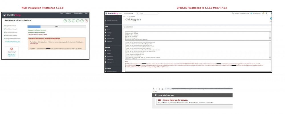

Hi,
I have this configuration:
  • WINDOWS SERVER 2019 with IIS 10
  • MySQL 8.0.16.0
  • PHP 7.2.16
  • PHPMYADMIN 4.9.0.1
  • Prestashop 1.7.6.0   /   1.7.5.2
I tried both to make a NEW installation Prestashop 1.7.6.0 and UPDATE from 1.7.5.2 but I have problems.
If I make a NEW installation Prestashop 1.7.6.0 at 23% appear a error message:    1: Template "C:\inetpub\wwwroot\XXXXXX\mails\themes\modern\core\account.html.twig" is not defined.
If I make a NEW installation Prestashop v1.7.5.2 the installation it's OK, but if I make a UPDATE to 1.7.6.0 appear a error message and If I refresh the page appear:   500 - Internal server error.
Thanks in advace for any help!
MySQL 8.0.16.0
PHP 7.2.16
PHPMYADMIN 4.9.0.1
Prestashop 1.7.6.0
I did a complete new installation test of Prestahop 1.7.6.0 and when appear the problem at 23% I remove the MODERN directory and procede with the installation.
At the end of installation I insert in the final path the MODERN directory and everything seems to work properly.
Now I have “only” these problem on the back office when I click on:
IMPROVE -> PAYMENT -> PAYMENT METHODS
IMPROVE -> INTERNATIONAL -> TAXES
CONFIGURE -> STORE PARAMETERS -> TRAFFIC & SEO
Appear the message: Server error - 500 - Internal server error -There is a problem that does not allow you to view the desired resource.
If I enabling the Debug Mode these problems do not occur.
I removed the ps_mbo module and can now log in without problem at:
The problem remains with:
Kind regards
