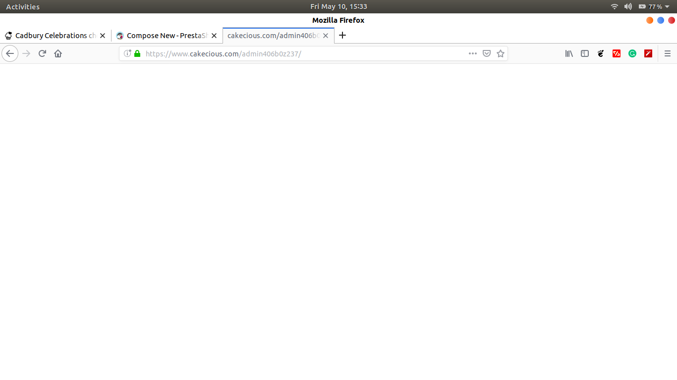

Himanshubishtt Posted May 10, 2019 Share Posted May 10, 2019 Hi, I have upgraded the PHP version 5.6.40 to 7.2.17 for my PrestaShop shop. But after upgrading the front office is working fine but the back office is showing a white blank page. (attachment) Why is this happening? Please help Regards, Link to comment Share on other sites More sharing options...
Janett Posted May 10, 2019 Share Posted May 10, 2019 What is your Prestashop version ? https://devdocs.prestashop.com/1.7/basics/installation/system-requirements/ Link to comment Share on other sites More sharing options...
Himanshubishtt Posted May 10, 2019 Author Share Posted May 10, 2019 Sir, my ps version is 1.7.2. Thanks Link to comment Share on other sites More sharing options...
Janett Posted May 10, 2019 Share Posted May 10, 2019 Prestashop 1.7.2 is not compliant with PHP 7.2, only PHP 7.1 maximum. Prestashop 1.7.5 is compliant with PHP 7.2 maximum Moreover if Prestashop is compliant, your modules can be too oldest to be compliant with PHP 7 1 Link to comment Share on other sites More sharing options...

Himanshubishtt Posted May 10, 2019 Author Share Posted May 10, 2019 Thank you so much for this valuable information. So I changed my PHP version to normal which is 5.6.40. Now everything works fine. But just for future reference if I want to change the PHP version to 7.1 on Ps 1.7.2, I can do it without any problem, right? Regards, Link to comment Share on other sites More sharing options...
Janett Posted May 10, 2019 Share Posted May 10, 2019 @Himanshubishtt Prestashop 1.7.2 is compliant with PHP 7.1 maximum. If you want to use PHP 7.2 you need to upgrade Prestashop to version 1.7.5 If you want to use PHP 7.3 you need to wait the release of Prestashop 1.7.7 and follow the work in progress here : https://github.com/PrestaShop/PrestaShop/issues/12461 Link to comment Share on other sites More sharing options...
