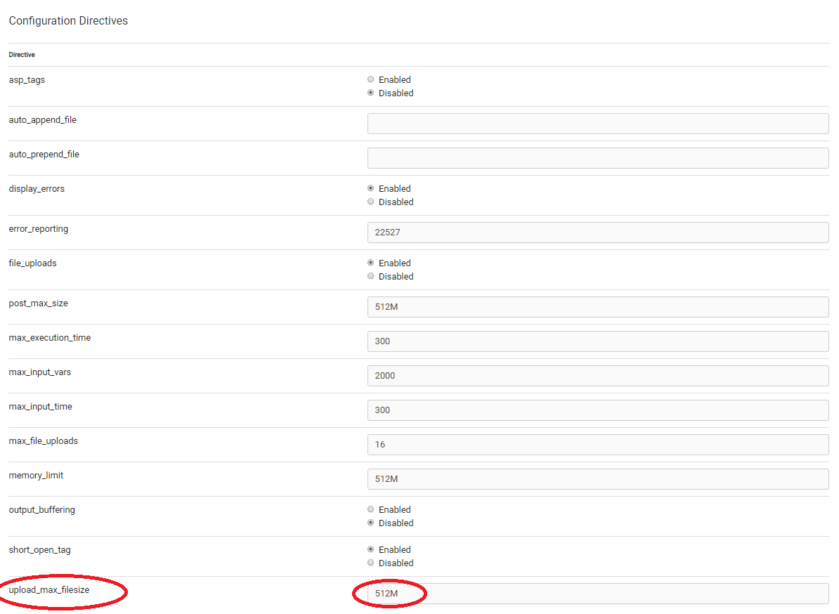

I already contacted my host provider, they checked PHP settings and confirmed that my max file size was set to 150M but they upped it to 512M anyway.  It still doesn't work.
I cannot find any max file upload setting that matches the message I am getting "File is too big (68.07MiB). Max filesize: 50MiB."

Then I am back to square one, as I also already mentioned, my host says the upload file size is set to 512 (previously 150).  Nothing on the host side is set to 50 according to host help desk.

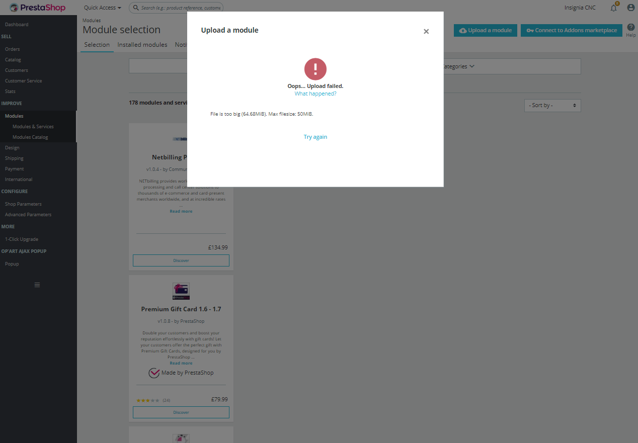

Hi JBW, it's not just prestashop upgrade that has the issue, any module over 50Mb will not install.  No I am not using the 1-click upgrade module.
I am trying to install the same way i have always done it (succesfully in the past), go into "modules", "modules & services", click "upload a module", click "select file".  Navigate to the zip file I previously downloaded.
Ok, then there is still someting worng with your upload limit setting - guess your php.ini might only work in a local folder. As a worksaround you can copy/unzip  the module per FTP to your server and install then in the backoffice module catalog.
