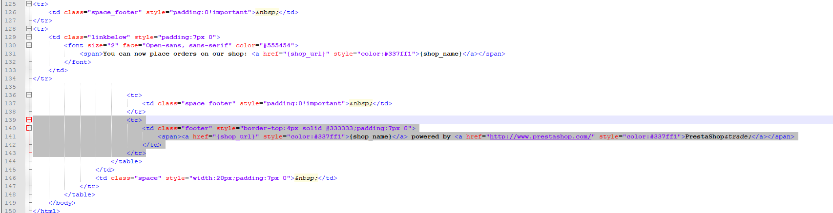

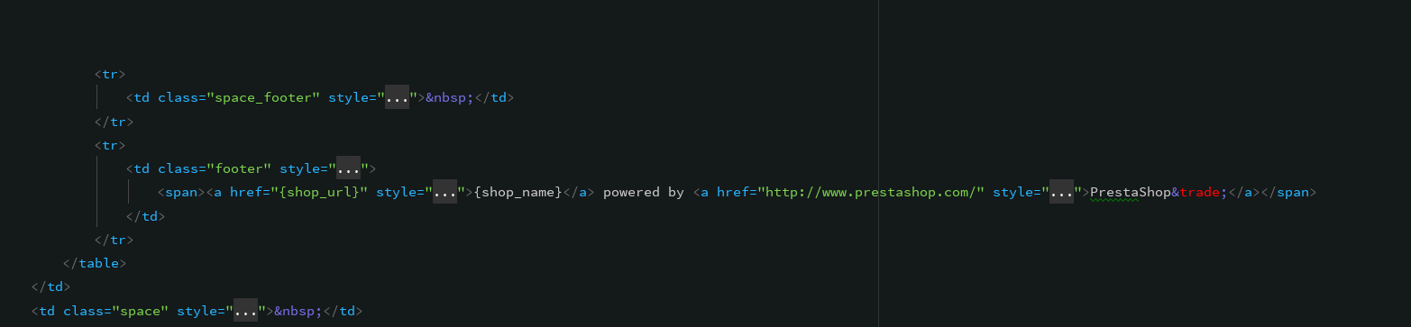

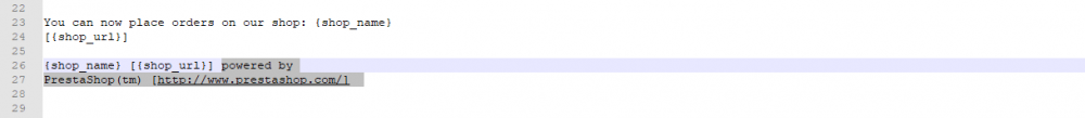

After spending almost a day trying to figure it out I have found the solution on Prestashop 1.7.6.4 - there is a known bug that when you try edit translations in back office it does not save and I can't help but wonder if intentional to keep prestashop signature on emails (otherwise just a bug - noted as a bug). Long story short... do this:
1- You need to download files by FTP or similar from this directory: \themes\[THEME]\mails\[LANGUAGE]\
2- Edit both the *.html (first image below) and *.txt (second image below) files to remove the link. I use and prefer Notepad+ + for editing - see highlighted sections to look for and delete.
*.html
*.txt
3- Upload and overwrite existing files. Done!
HANDY TIP TO SPEED UP PROCESS: Notepad+ + allows you to record the process and 'replay/play' it to repeat process on the file. ie: 1- Press 'Record' (see below image) / 2- 'Find' highlighted/copied text / 3- 'Right click' text and 'Delete' text / 4- Click 'File' then 'Save' / 5- Click 'File' then 'Close' / 6- Press 'Stop' to Stop Recording / 7- Press 'Play' on each file to repeat process (create a recording for *.html files and a recording for *.txt files).
