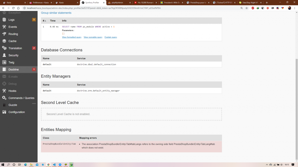

Hi! I have the same problem my presta is 1.7.6.7
I have upgraded my php to 7.2 and I cleared cache.
Still have those errors, backend works only in dev mode true
PrestaShopBundle\Entity\Tab - The association PrestaShopBundle\Entity\Tab#tabLangs refers to the owning side field PrestaShopBundle\Entity\TabLang#tab which does not exist.
PrestaShopBundle\Entity\TabLang - The mappings PrestaShopBundle\Entity\TabLang#id and PrestaShopBundle\Entity\Tab#tabLangs are inconsistent with each other.
Edited by gbartosz83 (see edit history)

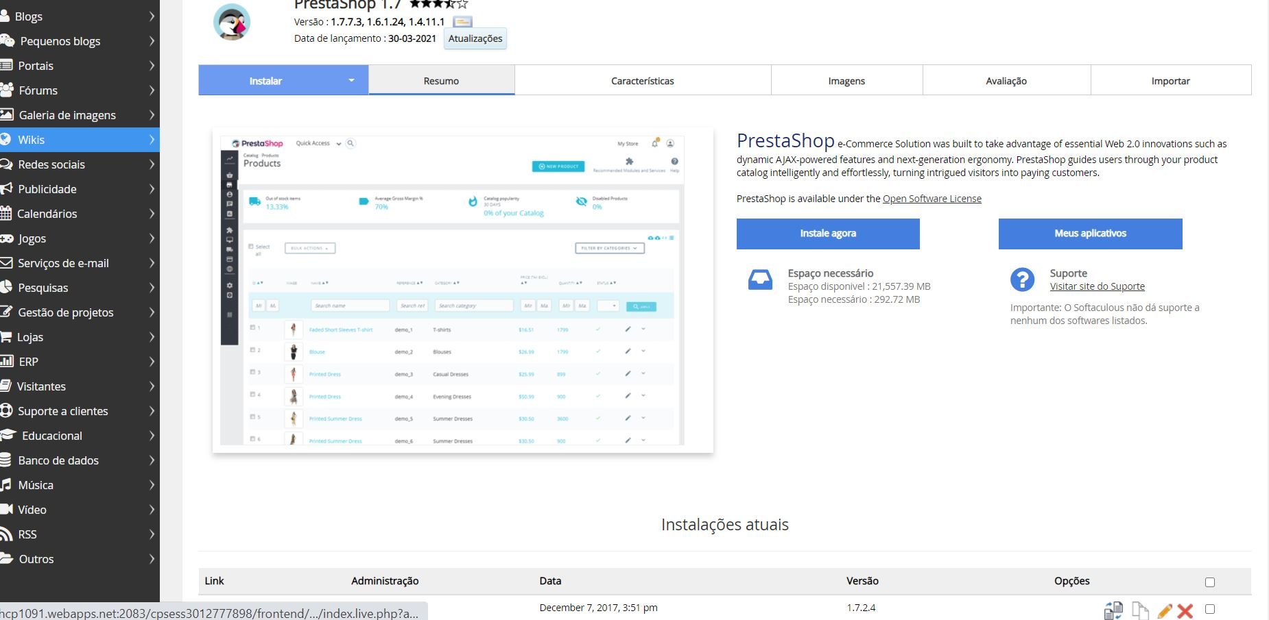

1.7.2.4 It was working OK until I updated (yesterday) the module ps_account.
Earlier this year I have tried to updated via 1clickUpdate, but server does not allow the amount of I/O and did not update.
Is there a way to do it via CPanel / using Softaculous (If I choose install now it will replace the previous version?) - see print screen in attachments.
1 minute ago, [email protected] said:
1.7.2.4
Wow thats really really old - newer versions of modules might cause the errors you are experiencing.
Best way to upgrade is 1-click-module. Always do this on a test instance first. This can be done locally as well and then copied back to the live server if tested successfully
tried 1-click-module and does not work. Do not know how to do it locally.
Do you think if I choose install now (in softaculous) it will replace the previous version?

On 3/8/2019 at 4:14 AM, Demuth said:
So I downgraded the php version to 7.2 got access to some new debug panels, I've never seen before.
So I found this one error I guess is the cause, but I can't decode it.
I hope someone have an idea
Entities Mapping
Class Mapping errors
  • The association PrestaShopBundle\Entity\Tab#tabLangs refers to the owning side field PrestaShopBundle\Entity\TabLang#tab which does not exist.

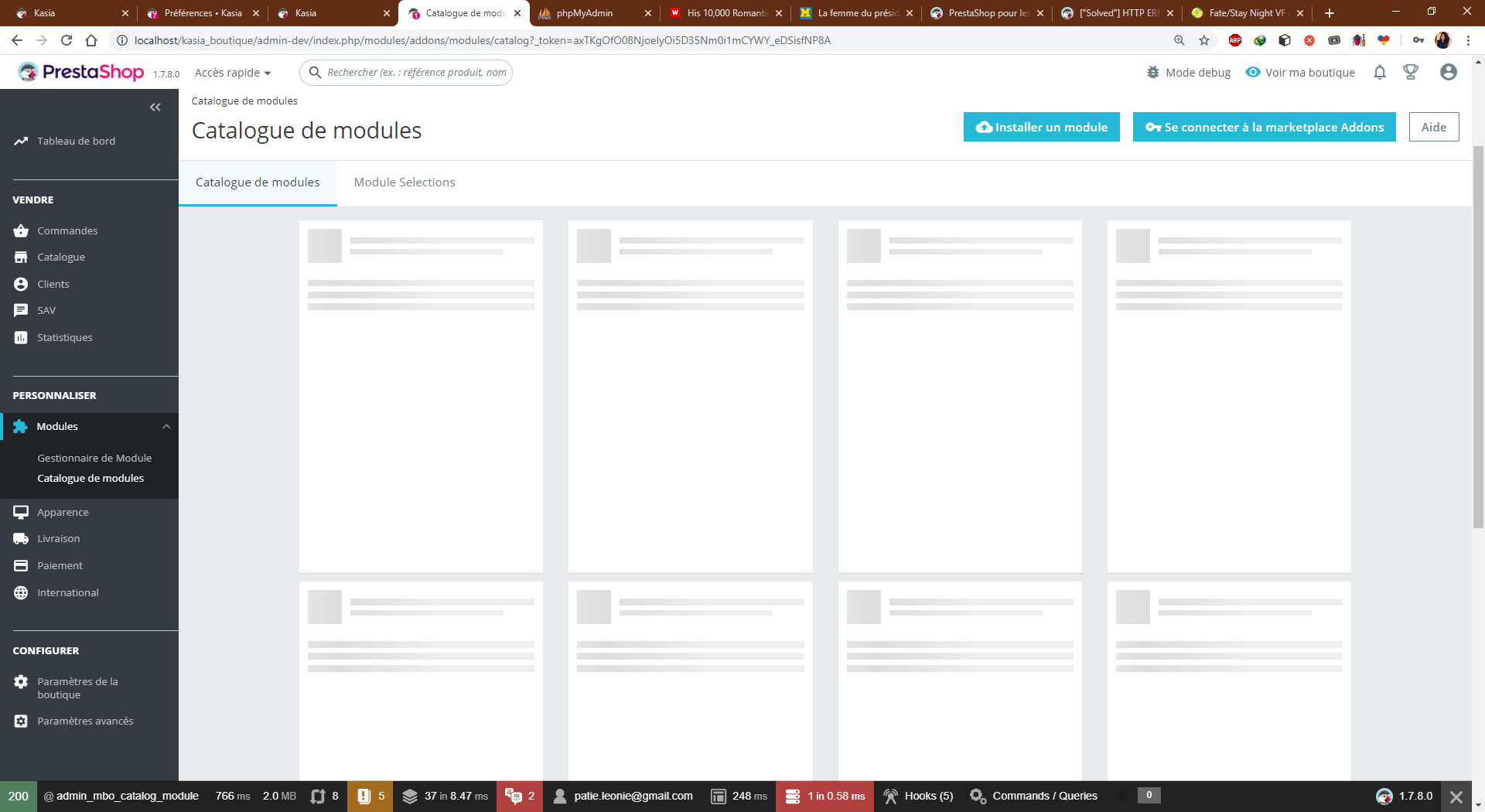

Uninstall ps_mbo & it will solve the issue.
