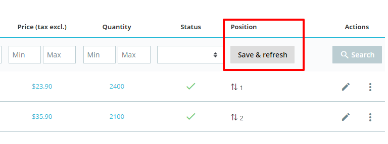

I have a Prestashop 1.7.5 (updated from 1.6 few months back), in which my client is working. All fine, until we decided to change "Pagination - Default order by" from 'Alphabetical' to 'Position within category' (Shop parameters > Product Settings). We want to reorder the products within their category, but somehow that gives problems with saving the new order. After filtering a category, the option to Reorder appears in the product table column 'Position'. When activating that, the button changes to a grey version Save & Refresh and drag-n-drop ordering of products is possible. After dragging one or a few products, the button is activated in blue color, indicating it can be clicked, but with doing this the new order is not being saved. And also, the option to Save & Refresh keeps being active and doesn't disappear anymore. Even logging in with a different browser (with no history to that website ever) this option is still activated and I can't get it deactivated anymore.
