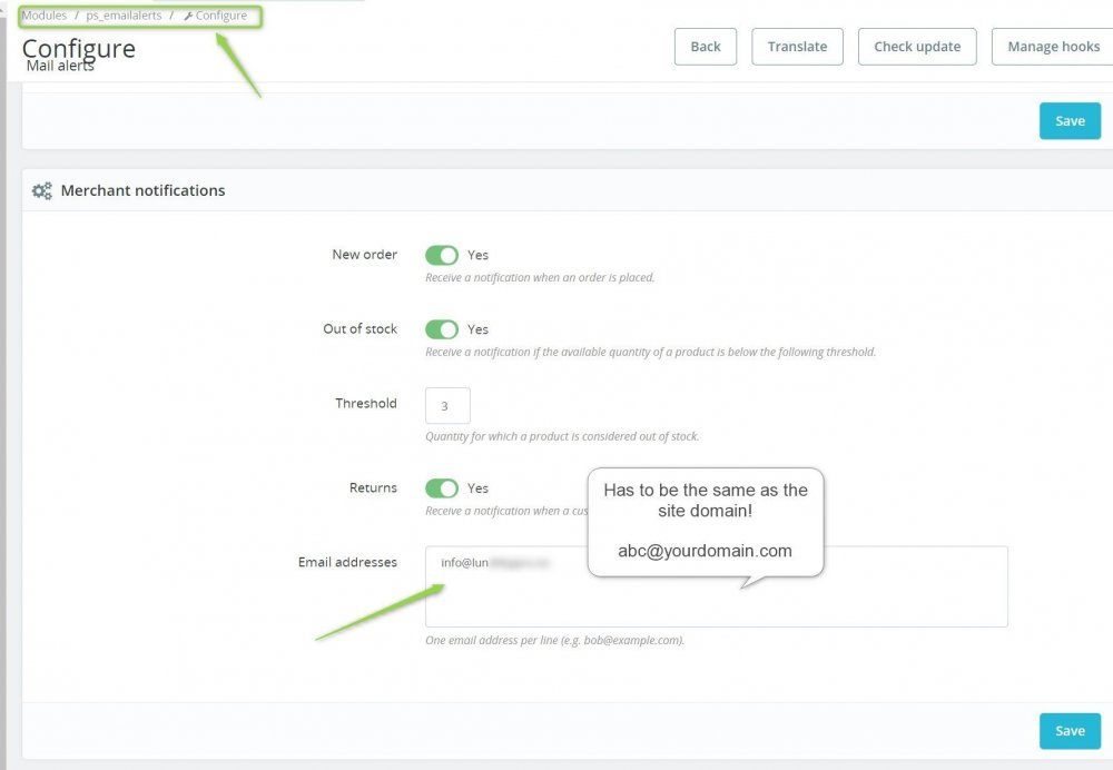

[email protected] Posted April 11, 2022 Share Posted April 11, 2022 I had the same problem and solved it by change the emailadress at the Module: ps_emailalerts / Configure I change the email to the same domain as the site! The sites name: abc.com Email: [email protected] I have got this problem at Wordpress as well, and this is the solution Link to comment Share on other sites More sharing options...
