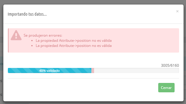

gusman126 Posted January 5, 2019 Share Posted January 5, 2019 Import - how to know in which line of the CSV is the error I'm importing prestashop combinations I have a file with +6000 lines The reading sections are made every 100 It gives me an error, I do not know which line I've checked it in error lines + How can I know what line it is? Can I make smaller sections? Link to comment Share on other sites More sharing options...
musicmaster Posted January 5, 2019 Share Posted January 5, 2019 Of course you can make smaller sections. BTW. I see 3005/6160 in your picture. That might give a clue. 1 Link to comment Share on other sites More sharing options...
gusman126 Posted January 6, 2019 Author Share Posted January 6, 2019 hace 20 horas, musicmaster dijo: Of course you can make smaller sections. BTW. I see 3005/6160 in your picture. That might give a clue. The warning does not help, it is using steps of 100 I checked between 2900 and 3100, all right, I do not know which is the line that gives error How can I change the steps? Link to comment Share on other sites More sharing options...
musicmaster Posted January 6, 2019 Share Posted January 6, 2019 I don't know How to change the steps. Most likely it is hard coded in the source code and you need to dive in the code to find it. However, you can can cut out those 200 lines and import them in a test shop. And then 100, etc. Soon enough you will have a small enough number that you can look through them and notice suspect patterns. Link to comment Share on other sites More sharing options...
