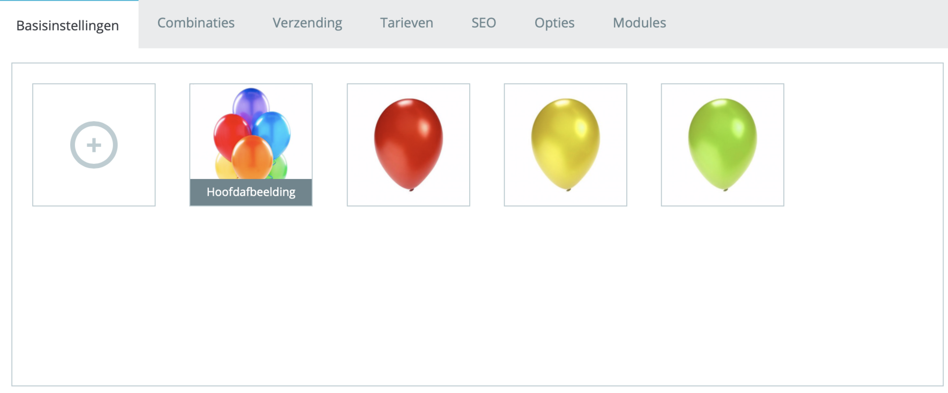

Situation: I create a combination product with 6 combinations and - for example - 4 images: the cover image to illustrate all possibilities, the image of combination 1+4, the image of combination 2+5 and the image of combination 3+6. However, the cover image to illustrate all possibilities is never shown...
All combinations are only linked to the correct image of that combination to improve the interpretation.

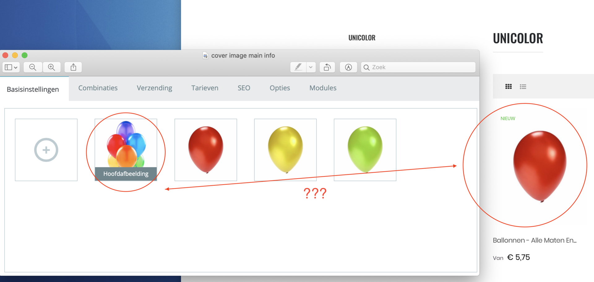

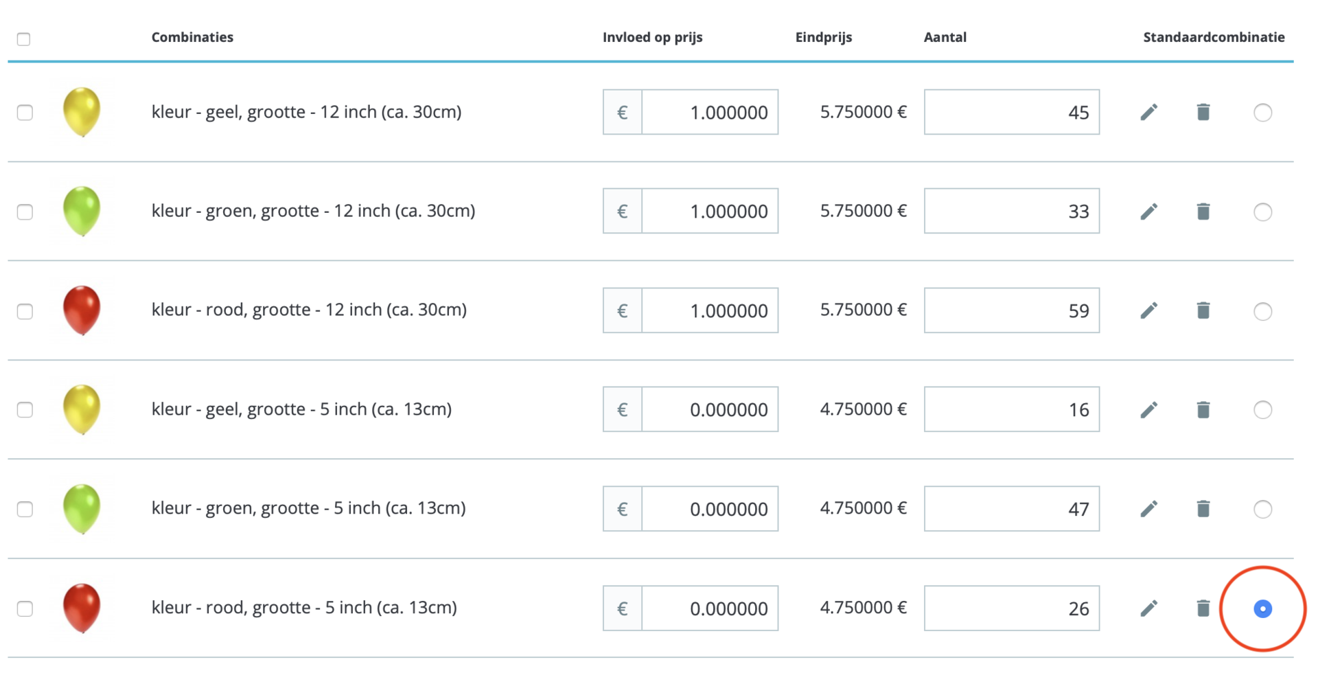

As one of the combinations is (always?) set as the default combination (for example combination 6), the image of combination 6 is always shown in the product list at the front end.
How can I force the cover image of the main information to be shown instead of the default combination image in the product list as a useful trigger to understand all possible combinations?
311868179_howtoshowcoverimageonresultapage.thumb.png.26821752ab07f0e6657eb74b14b705e0.png

Well i have 1.7.5 and this bug should been fixed a long time ago. If anyone is interested i found a solution.
1. Add combination named "p"
2. Attach this combination "p" to picture You want to have as cover. And set up as cover hit save button.
3. Turn on dissapiring combinations when out of stock.
In this case You have a combination that is Cover image and its out of stock so when someone enter the product it show only avalable combinations.
