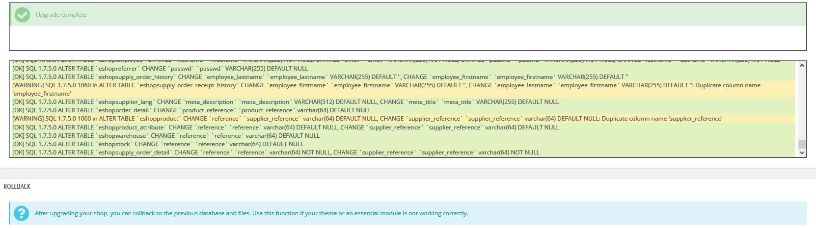

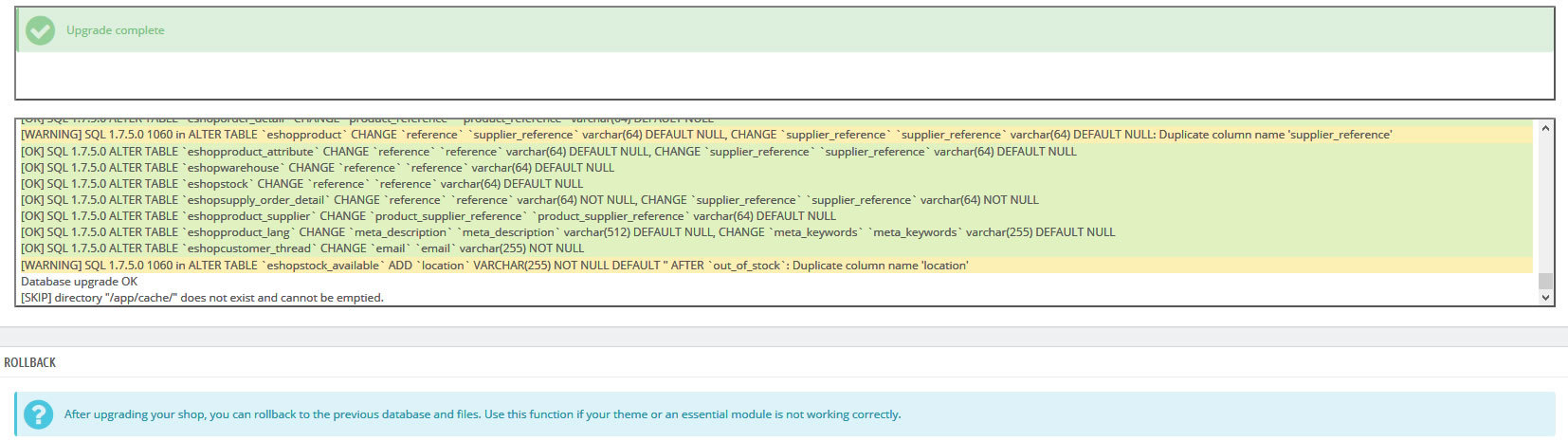

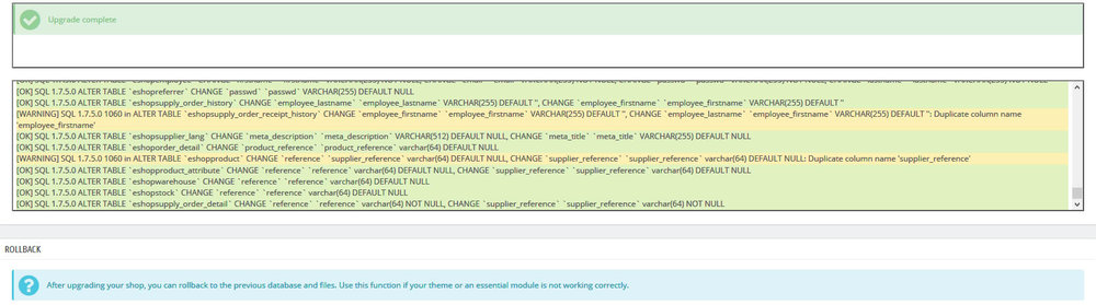

AndrewBalder77 Posted December 27, 2018 Share Posted December 27, 2018 I just finished the update process from 1.7.4.4 to 1.7.5.0. (via 1-click update - Expert mode - Directory update, since the other available options didn't work with my server, too many timeout errors) and I can confirm that there are indeed 3 SQL warnings about duplicate column names. The exact same errors you got. [WARNING] SQL 1.7.5.0 1060 in ALTER TABLE `eshopsupply_order_receipt_history` CHANGE `employee_firstname` `employee_firstname` VARCHAR(255) DEFAULT '', CHANGE `employee_lastname` `employee_firstname` VARCHAR(255) DEFAULT '': Duplicate column name 'employee_firstname' [WARNING] SQL 1.7.5.0 1060 in ALTER TABLE `eshopproduct` CHANGE `reference` `supplier_reference` varchar(64) DEFAULT NULL, CHANGE `supplier_reference` `supplier_reference` varchar(64) DEFAULT NULL: Duplicate column name 'supplier_reference' [WARNING] SQL 1.7.5.0 1060 in ALTER TABLE `eshopstock_available` ADD `location` VARCHAR(255) NOT NULL DEFAULT '' AFTER `out_of_stock`: Duplicate column name 'location' 1 Link to comment Share on other sites More sharing options...
