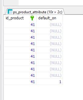

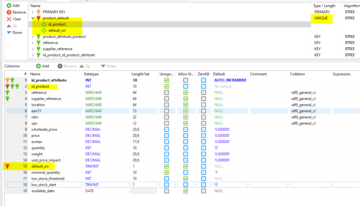

iulian3000 Posted August 31, 2020 Share Posted August 31, 2020 (edited) I have the same issue with ps 1.7.6.7, fresh install, no update from other version. Taking a peek into the database ive spotted this The problem is that when adding a new combination which is not default, the value for the default_on column is NULL, hence the errors. Edited August 31, 2020 by iulian3000 (see edit history) Link to comment Share on other sites More sharing options...
