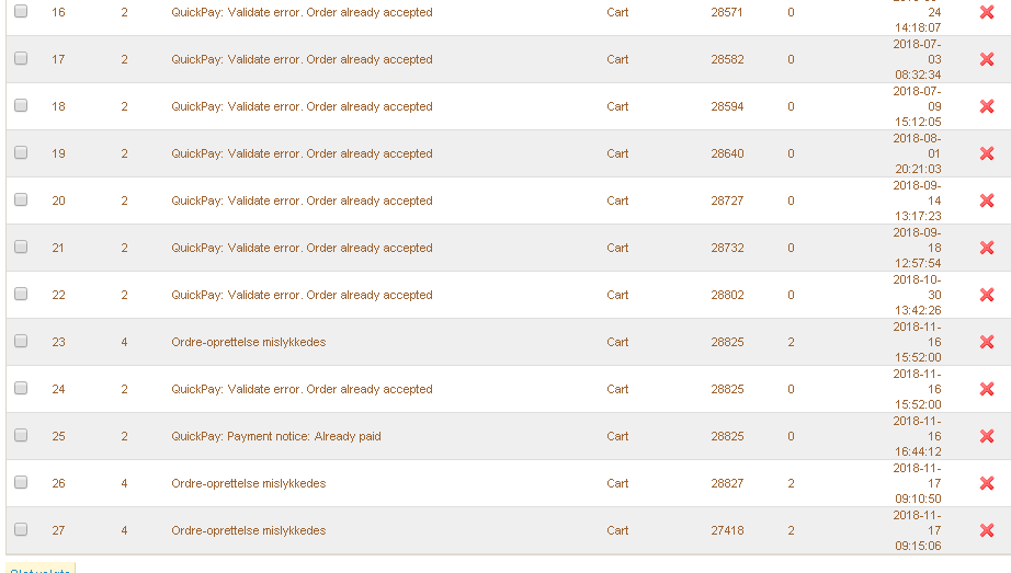

jgk-dk Posted November 17, 2018 Author Share Posted November 17, 2018 Kan det være Quickpay der laver fejl loggen siger på prestashop: Ordre-oprettelse mislykkedes QuickPay: Payment notice: Already paid QuickPay: Validate error. Order already accepted Link to comment Share on other sites More sharing options...
Guest Posted November 17, 2018 Share Posted November 17, 2018 (edited) Prøv så at kikke på Quickpay. Se om kurv nummeret optræder flere gange. Den er nøglen over til Quickley. Du skal nok kikke under payments - initials. Er det det nyeste quickpay modul? Prøv evt at nulstille modulet. Edited November 17, 2018 by Guest (see edit history) Link to comment Share on other sites More sharing options...
jgk-dk Posted November 17, 2018 Author Share Posted November 17, 2018 Hej Jeg har fundet 2 linier i loggen med samme kurv nummer - hvad skal jeg gøre herefter? Under Payment har jeg ikke initials.. Link to comment Share on other sites More sharing options...
jgk-dk Posted November 17, 2018 Author Share Posted November 17, 2018 4 Ordre-oprettelse mislykkedes Cart 28825 2 2018-11-16 15:52:00 24 2 QuickPay: Validate error. Order already accepted Cart 28825 0 2018-11-16 15:52:00 25 2 QuickPay: Payment notice: Already paid Cart 28825 0 2018-11-16 16:44:12 Link to comment Share on other sites More sharing options...

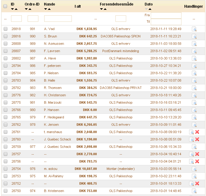

Guest Posted November 17, 2018 Share Posted November 17, 2018 Det var indkøbskurven der blev bedt om. Link to comment Share on other sites More sharing options...
jgk-dk Posted November 17, 2018 Author Share Posted November 17, 2018 Øøh det ene er da cart Link to comment Share on other sites More sharing options...
Guest Posted November 17, 2018 Share Posted November 17, 2018 4 minutes ago, jgk-dk said: Øøh det ene er da cart Sorry. Nu har jeg lige lagt en vare i kurven fra det link du lægge. Hvilken kurv nummer fik den? Link to comment Share on other sites More sharing options...
jgk-dk Posted November 17, 2018 Author Share Posted November 17, 2018 Link to comment Share on other sites More sharing options...
Guest Posted November 17, 2018 Share Posted November 17, 2018 O. Så er du kommet forbi det nummer som drillede. Prøv at se om du kan gennemføre en ordre nu. Det burde du kunne efter min mening. Link to comment Share on other sites More sharing options...

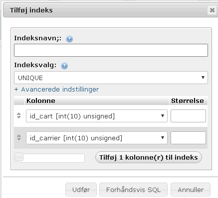

Prestawise Posted November 17, 2018 Share Posted November 17, 2018 Sådan som jeg ser det, er det pga. dine cart_ids allerede er brugt... Hvis du har adgang til phpmyadmin prøv at tjekke den tabel der hedder cart_ids og se om numrene stemmer overens. Link to comment Share on other sites More sharing options...
Guest Posted November 17, 2018 Share Posted November 17, 2018 Så må jeg melde pas. Vent til Kjeld kommer forbi. Det er ham der har lavet modulet. Link to comment Share on other sites More sharing options...
jgk-dk Posted November 17, 2018 Author Share Posted November 17, 2018 3 minutes ago, Prestawise said: Sådan som jeg ser det, er det pga. dine cart_ids allerede er brugt... Hvis du har adgang til phpmyadmin prøv at tjekke den tabel der hedder cart_ids og se om numrene stemmer overens. Hvilke numre taler du om her? Link to comment Share on other sites More sharing options...
jgk-dk Posted November 17, 2018 Author Share Posted November 17, 2018 6 minutes ago, jgk-dk said: Hvilke numre taler du om her? Link to comment Share on other sites More sharing options...

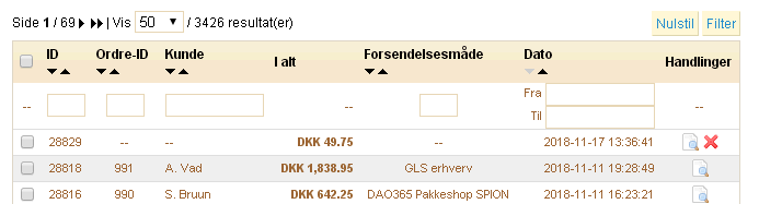

jgk-dk Posted November 17, 2018 Author Share Posted November 17, 2018 Det ser ud til at cart ikke opdateres i databasen???? Link to comment Share on other sites More sharing options...
Guest Posted November 17, 2018 Share Posted November 17, 2018 Prøv at sortere de numre faldende. Link to comment Share on other sites More sharing options...
jgk-dk Posted November 17, 2018 Author Share Posted November 17, 2018 4 minutes ago, pertho said: Prøv at sortere de numre faldende. så kom 28829 Link to comment Share on other sites More sharing options...

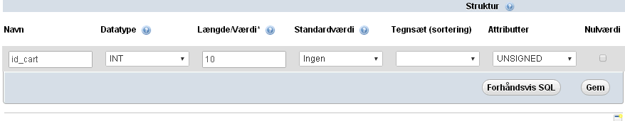

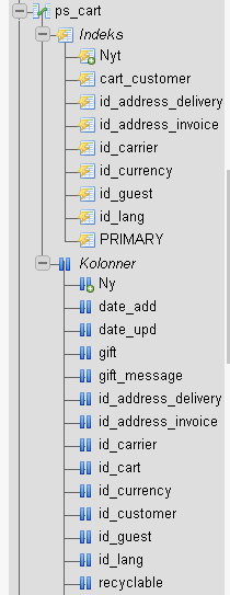

Prestawise Posted November 17, 2018 Share Posted November 17, 2018 Prøv at find tabellen ps_cart åben settings og se hvad auto increment parameter står til. Sammenlign det med det sidst brugte cart_id i tabellen ps_orders. Så sætter du auto increment (i ps_cart) til det sidste brugte cart_id fra ps_orders + 1 HUSK AT TAGE BACKUP AF DIN DATABASE INDEN. Link to comment Share on other sites More sharing options...
jgk-dk Posted November 17, 2018 Author Share Posted November 17, 2018 9 minutes ago, Prestawise said: Prøv at find tabellen ps_cart åben settings og se hvad auto increment parameter står til. Sammenlign det med det sidst brugte cart_id i tabellen ps_orders. Så sætter du auto increment (i ps_cart) til det sidste brugte cart_id fra ps_orders + 1 HUSK AT TAGE BACKUP AF DIN DATABASE INDEN. Link to comment Share on other sites More sharing options...
jgk-dk Posted November 17, 2018 Author Share Posted November 17, 2018 Der er 2 der er NYE hvad er disse? Link to comment Share on other sites More sharing options...
jgk-dk Posted November 17, 2018 Author Share Posted November 17, 2018 Dette kan da ikke være normalt at vise låst Link to comment Share on other sites More sharing options...
