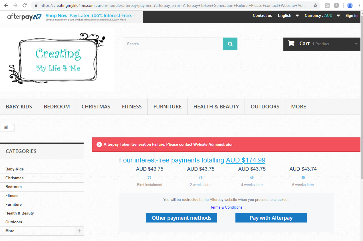

I've installed the Afterpay module and it has uploaded fine except when I go through the purchase process.
When I click Afterpay as the payment, this appears on the screen "Afterpay Token Generation Failure. Please contact Website Administrator".

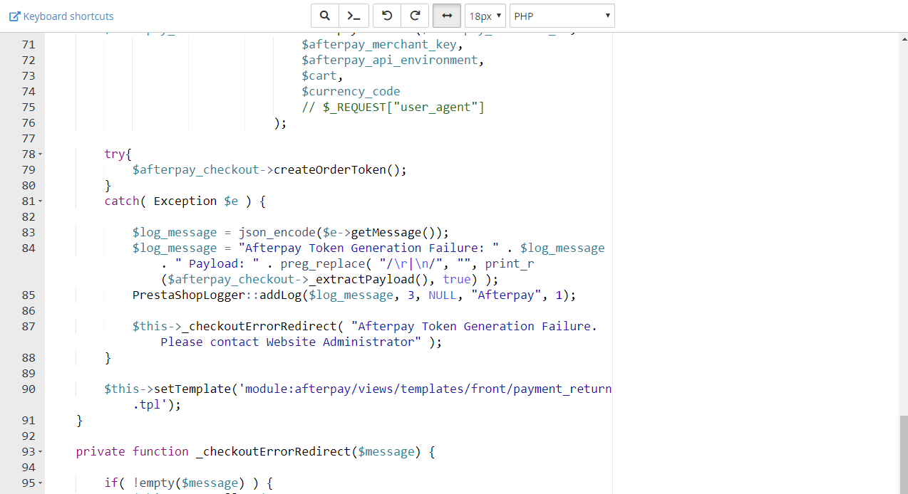

  1. The file in question is afterpay/controllers/front/validation.php - Line number 79
  2. Line 80 handles the Order Token Creation
  3. If unsuccessful, line 90 displays the error that Creating My life 4 Me is currently experiencing.
As it is a live instance, Afterpay support is limited due to security and privacy concerns. As the SAT was successful, the recommendation is to confirm parity with the development instance.
I do not know what I'm supposed to change to correct this. I've also attached a screenshot of the suggested lines that may contain the error from the recommended file.
