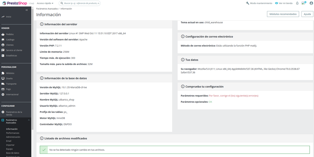

Hi, I update my store 1.7.4.2 -> 1.7.4.3 with 1-click-upgrade, and now appears the error:
5bcdd2267c5c7_Capturadepantallade2018-10-2210-25-57.thumb.png.00abdf92fe528c1aac41873931337fb5.png
But it dont show any correction, for this reason I tryed with a new clean install of presta 1.7.4.3 and dont listed any error in required parameters, with this test, I discard any change to server side.

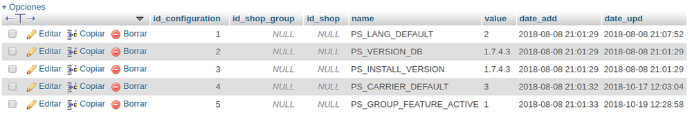

Before the updating Presta 1.7.4.2 to 1.7.4.3 with 1-click-upgrade, displayed  ok and ok, I tryed upgrade manually and when I execute https://dom.com/install/upgrade/upgrade.php display error 32 (dont anything to update)I check in the Database the version of the BD and Files: and display for the install version of files 1.7.4.2 and DB 1.7.4.3 I changed to 1.7.4.3 and dont solved yet.

Any idea??? The shop work fine, but Display the error of parameters necesary.... When dont changing anything in the server or php.ini config.
After update I having a error to update module filters, I solved modify the Install Version and Version DB to 1.7.4.3 and updating manually the files in the host, This way I can update the module....
But yet display the message of required parameters
