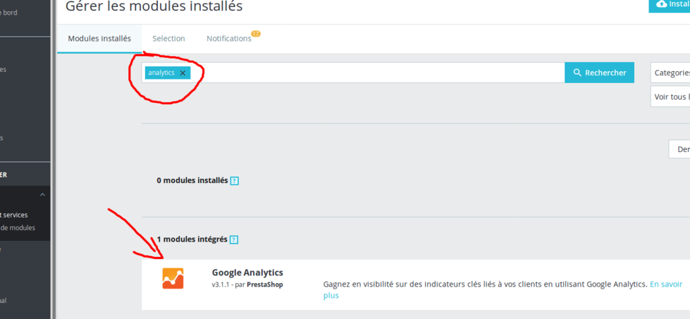

doekia Posted October 21, 2018 Share Posted October 21, 2018 Franchement ? Je sais que la recherche dans la page module de la 1.7 est une misère, mais ... en cherchant analytics on trouve vite le module natif (et gratuit) de la solution. Link to comment Share on other sites More sharing options...
doekia Posted October 21, 2018 Share Posted October 21, 2018 J'avais prévu de te mettre une capture écran mais il semble que le forum soit encore pété Quote There was a problem processing the uploaded file. -200 Link to comment Share on other sites More sharing options...
doekia Posted October 21, 2018 Share Posted October 21, 2018 Link to comment Share on other sites More sharing options...
