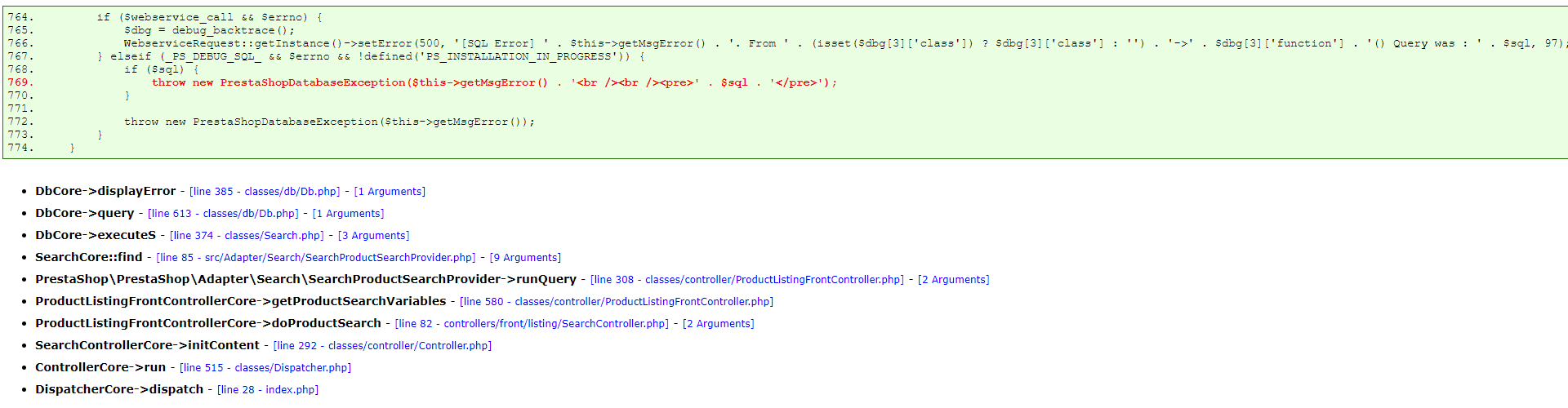

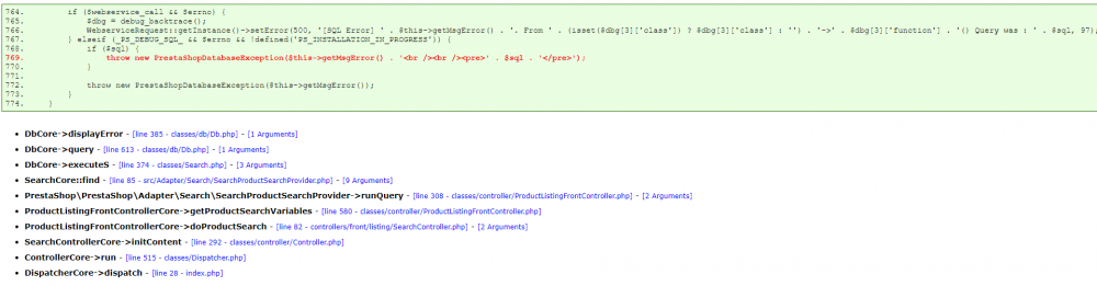

Antakarana Posted August 27, 2020 Share Posted August 27, 2020 (edited) Hi!!! I have a similar problem ona a PS 1.7.6.7 shop search bar doesnt work... actualy it only shows manufacturer results, but it doesnt show any product results. When activating debug mode it shows this error code when I perform any search: [PrestaShopDatabaseException] Key 'id_product' doesn't exist in table 'product_attribute_shop'<br /><br /><pre>SELECT p.*, product_shop.*, stock.out_of_stock, IFNULL(stock.quantity, 0) as quantity, pl.`description_short`, pl.`available_now`, pl.`available_later`, pl.`link_rewrite`, pl.`name`, image_shop.`id_image` id_image, il.`legend`, m.`name` manufacturer_name ,( SELECT SUM(weight) FROM prstshp_search_word sw LEFT JOIN prstshp_search_index si ON sw.id_word = si.id_word WHERE sw.id_lang = 1 AND sw.id_shop = 1 AND si.id_product = p.id_product AND (sw.word LIKE '%moet%') ) position, DATEDIFF( p.`date_add`, DATE_SUB( "2020-08-27 00:00:00", INTERVAL 150 DAY ) ) > 0 new, product_attribute_shop.minimal_quantity AS product_attribute_minimal_quantity, IFNULL(product_attribute_shop.`id_product_attribute`,0) id_product_attribute FROM prstshp_product p INNER JOIN prstshp_product_shop product_shop ON (product_shop.id_product = p.id_product AND product_shop.id_shop = 1) INNER JOIN `prstshp_product_lang` pl ON ( p.`id_product` = pl.`id_product` AND pl.`id_lang` = 1 AND pl.id_shop = 1 ) LEFT JOIN `prstshp_product_attribute_shop` product_attribute_shop FORCE INDEX (id_product) ON (p.`id_product` = product_attribute_shop.`id_product` AND product_attribute_shop.`default_on` = 1 AND product_attribute_shop.id_shop=1) LEFT JOIN prstshp_stock_available stock ON (stock.id_product = `p`.id_product AND stock.id_product_attribute = 0 AND stock.id_shop = 1 AND stock.id_shop_group = 0 ) LEFT JOIN `prstshp_manufacturer` m FORCE INDEX (PRIMARY) ON m.`id_manufacturer` = p.`id_manufacturer` LEFT JOIN `prstshp_image_shop` image_shop FORCE INDEX (id_product) ON (image_shop.`id_product` = p.`id_product` AND image_shop.cover=1 AND image_shop.id_shop=1) LEFT JOIN `prstshp_image_lang` il ON (image_shop.`id_image` = il.`id_image` AND il.`id_lang` = 1) WHERE p.`id_product` IN (3718,4214,5271,5313,5585,5586,5587) GROUP BY product_shop.id_product ORDER BY position desc LIMIT 0,24</pre> at line 769 in file classes/db/Db.php DbCore->displayError - [line 385 - classes/db/Db.php] - [1 Arguments] DbCore->query - [line 613 - classes/db/Db.php] - [1 Arguments] DbCore->executeS - [line 374 - classes/Search.php] - [3 Arguments] SearchCore::find - [line 85 - src/Adapter/Search/SearchProductSearchProvider.php] - [9 Arguments] PrestaShop\PrestaShop\Adapter\Search\SearchProductSearchProvider->runQuery - [line 308 - classes/controller/ProductListingFrontController.php] - [2 Arguments] ProductListingFrontControllerCore->getProductSearchVariables - [line 580 - classes/controller/ProductListingFrontController.php] ProductListingFrontControllerCore->doProductSearch - [line 82 - controllers/front/listing/SearchController.php] - [2 Arguments] SearchControllerCore->initContent - [line 292 - classes/controller/Controller.php] ControllerCore->run - [line 515 - classes/Dispatcher.php] DispatcherCore->dispatch - [line 28 - index.php] Can anybody help me?? 🙄 thanks in advace Edited August 27, 2020 by Antakarana (see edit history) Link to comment Share on other sites More sharing options...
lototo Posted August 28, 2020 Share Posted August 28, 2020 Add index to database product_attribute_shop table Key 'id_product' doesn't exist in table 'product_attribute_shop' Link to comment Share on other sites More sharing options...
Antakarana Posted September 3, 2020 Share Posted September 3, 2020 (edited) En 28/8/2020 a las 5:50 PM, lototo dijo: Add index to database product_attribute_shop table Key 'id_product' doesn't exist in table 'product_attribute_shop' Thanks for your answer... Im not a professional of sql..... how can I make that query? Thanks in advance! PS. I have fixed it by adding the index that table.... a friend of mine who is a master on SQL fixed it Edited September 14, 2020 by Antakarana (see edit history) Link to comment Share on other sites More sharing options...
