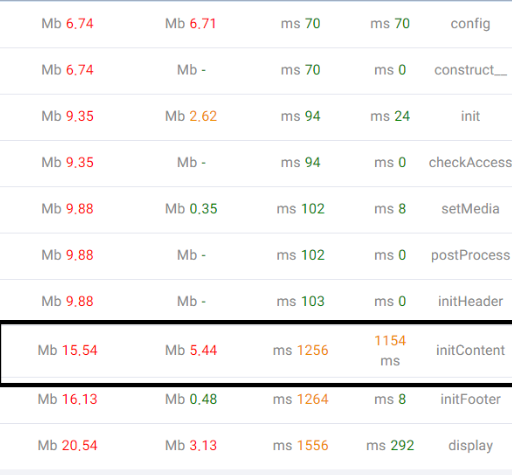

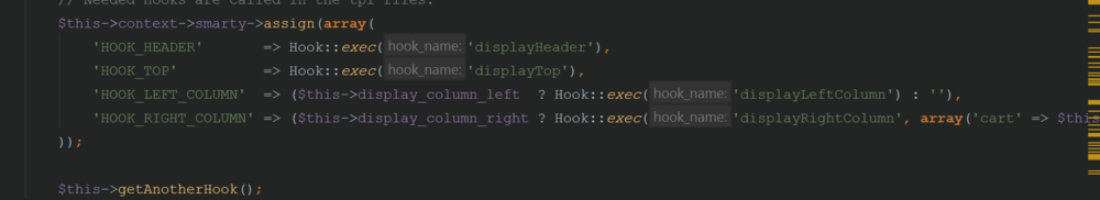

George Posted August 14, 2018 Share Posted August 14, 2018 Hello guy i would like to inform you Prestashop architecture and method of programing is very old.they are still using hook to call controller and never use some good idea and solution if you check should write thouthands line to do simple job. it has very bad structure. Please have a look inside Initcontent file I will share some photo you will understand below picture show this lines always run every page look below how effect to open a page .Indeed a page 10times become faster to download when i remove this Left one include codes and right one is remove from 1154ms convert to 15ms. indeed the codes developed inside Prestashop structure like for 1000 years ago. Look how react when we test only 10 concurrent and 100 Request to a server with 16GB memory and 16 core CPU . you will see like system going to die Indeed prestashop good for a Woman Beauty salon have only 10 products and have 200 customers. Now Amgento and Shopify at least use new technologies . One more things is weak community of Prestashop there is no community because its not an american community and its all a French software .so no one answer you at all Thanks, George Let me show you concurrent users when connect to a big server how its act Link to comment Share on other sites More sharing options...

Knowband Plugins Posted August 14, 2018 Share Posted August 14, 2018 (edited) Hi, As per my knowledge, the slow response of the hook will depend upon the number of modules which are calling that particular hook. Even a single module which is calling that particular hook can slow down the entire flow depending upon the processing being done in the module. The hook is similar to event/observer of the Magento. If any observer its taking time that it can slow down the entire code flow. Apart from that, The hook is being used most popular CMS i.e. Wordpress & also in Drupal so saying the hooks concept is very old which doesn't seem correct to me but yes definitely architecture of Magento is too far ahead. As per my experience, Magento is very slow comparative to Prestashop (Talking about the base code only). Speed can be improved using FPC & other caching technique which are applicable in case of PrestaShop as well. Hoping to see the server results. It would be good if you can compare the same with Magento Edited August 15, 2018 by Knowband Plugins (see edit history) Link to comment Share on other sites More sharing options...

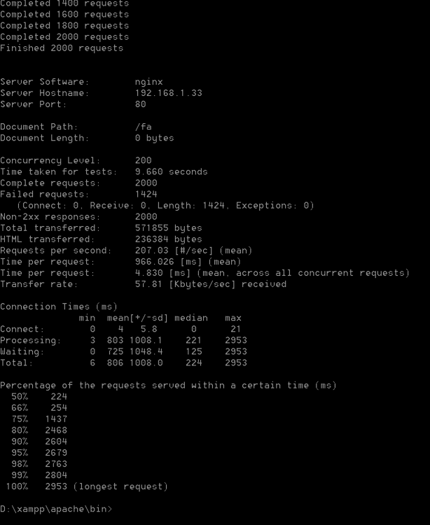

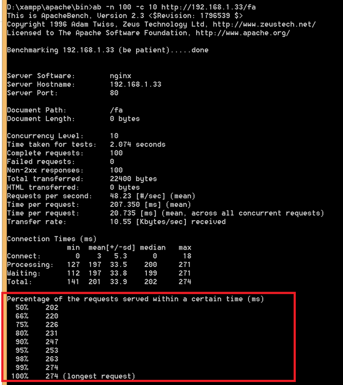

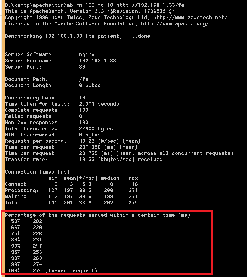

George Posted August 15, 2018 Author Share Posted August 15, 2018 As you can see inside this banckmark i place 2000 pcs concurrent 200 pcs as you see alot of failor. The system cant response at all. Indeed prestashop made to make more CPU consuming .Please have a look below this is i test very simple page. this page have nothing this is only Login page and have nothing only two modules is run this is 100 request 10 concurrent passed however as you see below .you never believe howmuch prestashop is slow. its not build for large scale. same computer we run another platform based on Node.JS can response 5000 Request with 500 concurrent. One of the problem in prestashop no one answer you.Its like an old city all people die inside this city and no one say hello Link to comment Share on other sites More sharing options...
