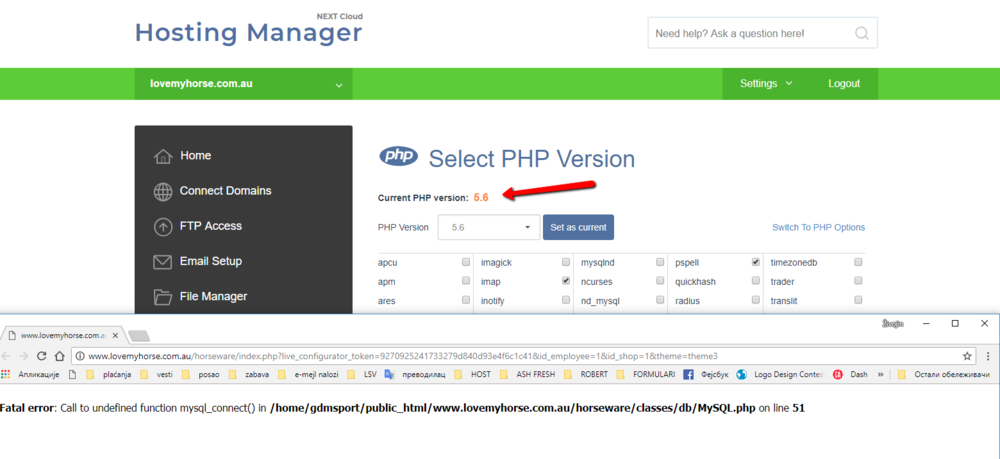

Fatal error: Call to undefined function mysql_connect() in /public_html/......./classes/db/MySQL.php on line 51
Is this mean no connection to database and where to point attention to solving this problem?
BO is working perfect, FO is not work
DATA BASE IS CHECKED, NO ERROR

Check configuration screenshot, PHP is 5.4 bit old but if that worked before it should not be an issue.
Though @katicziv you can try to change to PHP 5.6. You have debug mode enabled I guess. But can you check server logs or
log folder in root maybe for more detailed stack trace of error.
