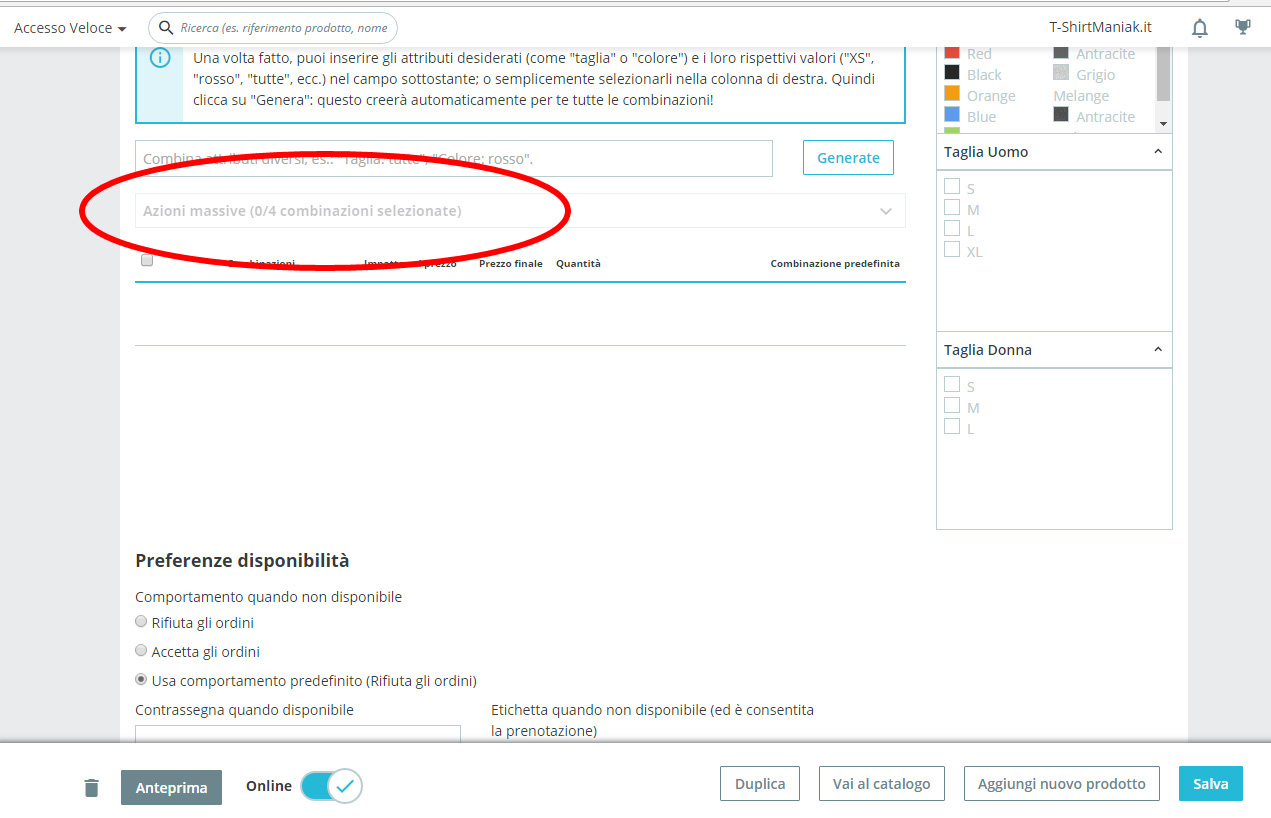

Drazh Posted April 17, 2018 Share Posted April 17, 2018 (edited) Hello everyone,I believe at the last update with the module "1-click upgrade", from version 1.7.2 to 1.7.3.1, I can create new products with combinations but I can not change or update the combinations of those already created. Even if I duplicate products, the tab from existing combinations does not open and remains unselectable. I said "I think" because with the previous version I created, duplicated and modified the product combinations without problems, then I did the update and for a few days I did not add any product, because I had focused on other aspects of the site.In the screenshot we see that the product has 4 combinations, but the drop-down menu remains permanently gray and can not be selected.Does anyone have the same problem or can you give me some suggestions?Thank you. Edited April 17, 2018 by Drazh (see edit history) Link to comment Share on other sites More sharing options...
Drazh Posted April 17, 2018 Author Share Posted April 17, 2018 Solved the fix, see instruction here: https://github.com/PrestaShop/PrestaShop/pull/8948/files Thank you! 1 Link to comment Share on other sites More sharing options...
