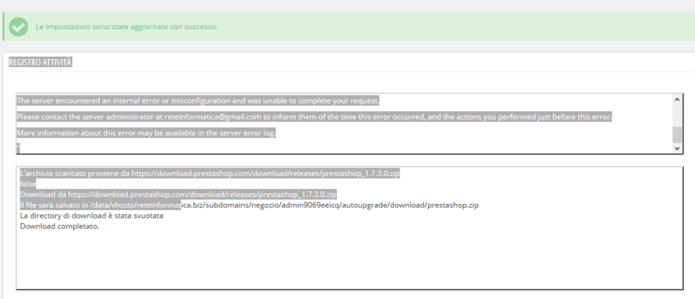

Sto tentando di aggiornare da 1.7.2.4 a 1.7.3.0 con 1-click upgrade. La checklist pre-aggiornamento mi da tutti i controlli positivi.

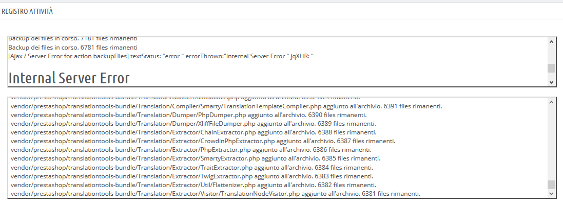

Mi scarica il file, il backup automatico viene effettuato, parte la decompressione dello zip e ad un certo punto mi da vari errori, ho tentato varie volte e ogni volta mi da un errore diverso ma secondo me riconducibile al web server (iltuohosting) in particolare a ngix
Gli errori sono questi:
  • 502 Bad Gateway
  • Server internal error
Ho cercato ma non sono riuscito a trovare una guida su come installare l'aggiornamento caricando i file via ftp e chiedo cortesemente a voi come si fa.
Grazie.

Errori di Apache:
  • mod_fcgid: stderr: PHP Warning: vsprintf(): Too few arguments in /src/PrestaShopBundle/Translation/PrestaShopTranslatorTrait.php on line 57, referer: http://urlsito/adminecc/index.php?controller=AdminSelfUpgrade&token=798de0d3220521da5aea51b8c0dda86f
  • mod_fcgid: stderr: PHP Warning: curl_setopt(): CURLOPT_FOLLOWLOCATION cannot be activated when an open_basedir is set in /classes/Tools.php on line 1899
  • (104)Connection reset by peer: mod_fcgid: error reading data from FastCGI server, referer: /index.php?controller=AdminSelfUpgrade&token=798de0d3220521da5aea51b8c0dda86f
  • AH01909: RSA certificate configured for negozio.reteinformatica.biz:443 does NOT include an ID which matches the server name
Errori di ngix
  • 30311#0: *95015114 recv() failed (104: Connection reset by peer) while reading response header from upstream
  • 9649#0: *98524502 recv() failed (104: Connection reset by peer) while reading response header from upstream
  • 30990#0: *99519912 recv() failed (104: Connection reset by peer) while reading response header from upstream
  • 12034#0: *101802190 upstream prematurely closed connection while reading response header from upstream
  • 12023#0: *101804213 upstream prematurely closed connection while reading response header from upstream
Edited by reteinformatica (see edit history)

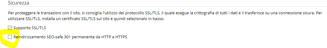

Allora, innanzitutto scusa per l'attesa ma ho avuto molto da fare. Come ho detto ho provato a reinstallare da zero Prestashop e non si apriva la pagina, ho scoperto perché: se spunto l'opzione di impostazione hosting presente nella foto mi dovrebbe reindirizzare automaticamente al protocollo https.. Così mi da l'errore con la pagina bianca nel browser. Se tolgo la spunta invece funziona ma non mi si apre col protocollo https ma http. L'installazione però è stata fatta in https senza problemi, il problema lo da all'accesso al negozio. Ora dovrei capire se è un problema di Prestashop o dell'hosting, precisando che ho altre 3 applicazioni su 3 sottodomini (stessa cosa Prestashop è un sottodominio) tutte su https che non hanno problemi.

con gli ecommerce dei miei clienti io ho seguito più volte questa strada e mi sono trovata bene: installazione e setup in http, generazione certificati https per il dominio/sottodominio, passaggio ad https da impostazioni PS come ultimo passo. Però dipende molto anche dall'hosting, quindi non so consigliarti con precisione.

Ok, mi mancava questo passaggio. Alla fine rimarrà un mistero il perchè non si aggiornava ma ci avevo perso anche troppo tempo, visto che comunque era una nuova installazione  con appena qualche modifica la tabula rasa era la via più pratica.
