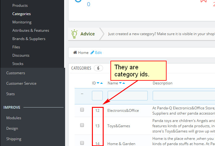

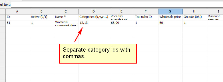

tantan199 Posted March 14, 2018 Share Posted March 14, 2018 If you can share me your files, I can help you to check. @RogueWaveLimited was right. See attached pictures. Another possible reason is that csv files you are using are wrong. If you are using 1.7, you can download correct csv files here https://www.sunnytoo.com/16535/import-edit-products-prestashop1-7-site-using-csv-files Link to comment Share on other sites More sharing options...
