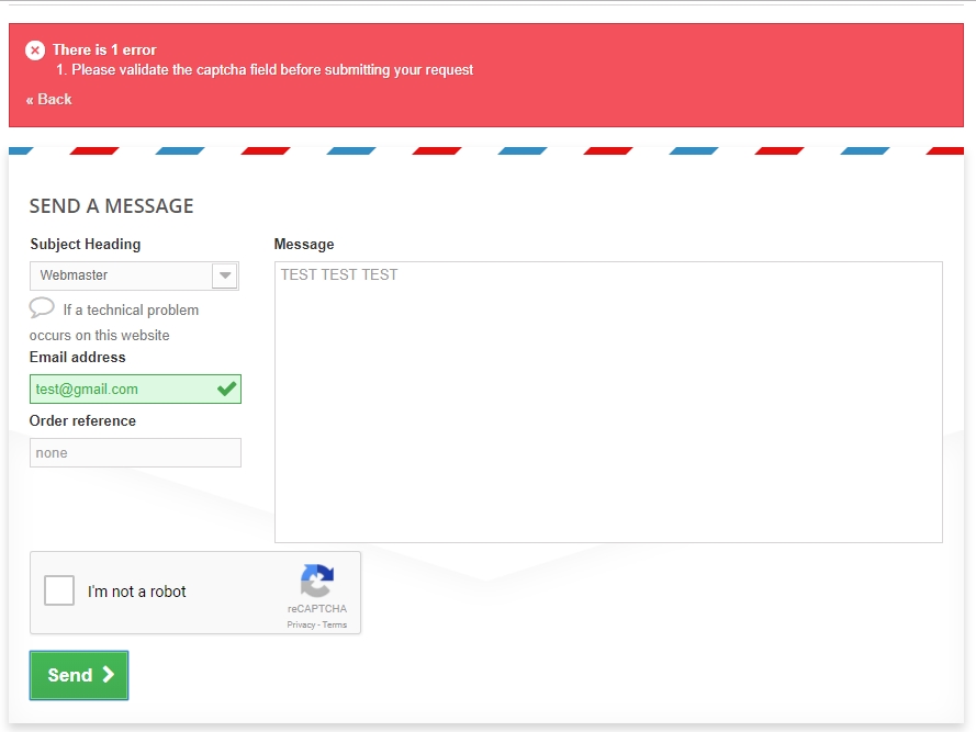

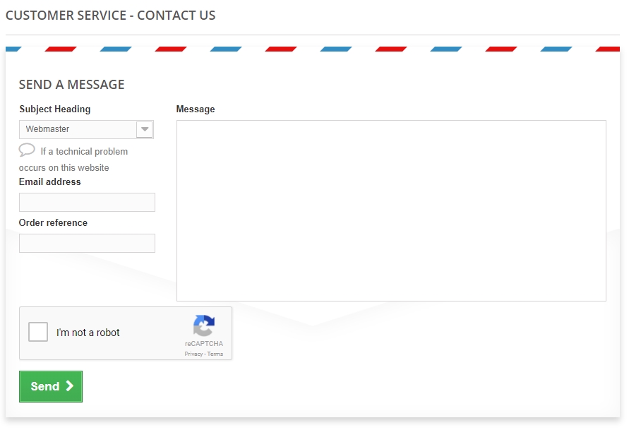

SlowLearner Posted February 26, 2018 Share Posted February 26, 2018 (edited) I understand what you're saying as I am using PS 1.6 and I am having the same issue. I've already installed reCAPTCHA on the CONTACT form and the bots are blowing right past it. I'm banning IP Addresses and complete ranges at a rate I would need to hire a full-time 24/7 hour employee just to do it. I need a way to change or disable the "CONTACT" form URL completely. This is NOT done by simply going in to PREFERENCES and editing the SEO/URL as the "CONTROLLER=CONTACT" URL still remains the same. Any help with this issue would be great! Thank you in advance. Example: whateversite(dot)com/index.php?controller=contact Edited To: whateversite(dot)com/index.php?controller=contact-us OR whateversite(dot)com/index.php?controller= Edited February 26, 2018 by SlowLearner (see edit history) Link to comment Share on other sites More sharing options...

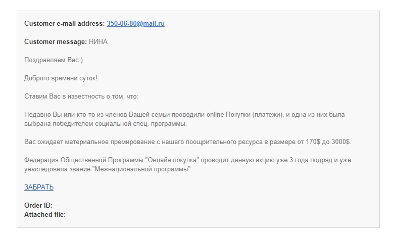

SlowLearner Posted February 27, 2018 Share Posted February 27, 2018 (edited) 11 hours ago, bellini13 said: Sounds like you have not properly installed reCaptcha then. There is the component that you install in the page content that challenges the user, but you also need to server side component that verifies the challenge. Sounds like you missed the server side portion, or the spam is not coming from the contact form, but perhaps a broken module like "send to a friend" which has known issues if you did not uninstall and delete it, or update it. The reCAPTCHA isn't installed incorrectly on the CONTACT page or on the server side. It makes the user checkmark "I'm Not A Robot" and the message SEND will fail if that isn't checked. [Please see the images I have enclosed of this] The bots are still able to send me emails using the CONTACT form even with reCAPTCHA installed. The SPAM coming from the CONTACT page and it's addressed to "WEBMASTER" so I know it's coming from the CONTACT form. [Please see image of CONTACT form SPAM message below] Additionally, I uninstalled the "Send To A Friend" module a long time ago so I know that isn't the problem. DO YOU KNOW HOW TO MAKE THE EDITS SHOWN BELOW TO CHANGE OR REMOVE THE CONTACT PAGE? ANY HELP WOULD BE GREAT. I need a way to change or disable the "CONTACT" form URL completely. This is NOT done by simply going in to PREFERENCES and editing the SEO/URL as the "CONTROLLER=CONTACT" URL still remains the same. Any help with this issue would be great! Thank you in advance. Example: whateversite(dot)com/index.php?controller=contact Edited To: whateversite(dot)com/index.php?controller=contact-us OR whateversite(dot)com/index.php?controller= Edited February 27, 2018 by SlowLearner Added Additional Information (see edit history) Link to comment Share on other sites More sharing options...
