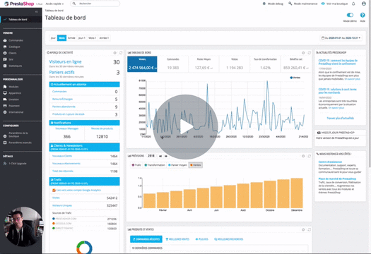

Mediacom87 Posted April 21, 2020 Share Posted April 21, 2020 Une petite vidéo explicative. Link to comment Share on other sites More sharing options...
Bruno6666 Posted April 21, 2020 Share Posted April 21, 2020 Oh my goood !! merciiiii Mediacom87 !! Là, je pense que l'on peut vraiment marqué ce post comme résolu Link to comment Share on other sites More sharing options...
