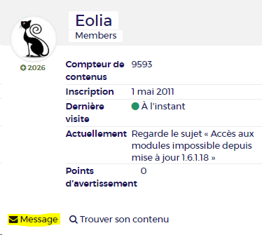

Eolia Posted February 14, 2018 Share Posted February 14, 2018 Cliquez sur mon pseudo, puis -> Message Link to comment Share on other sites More sharing options...
