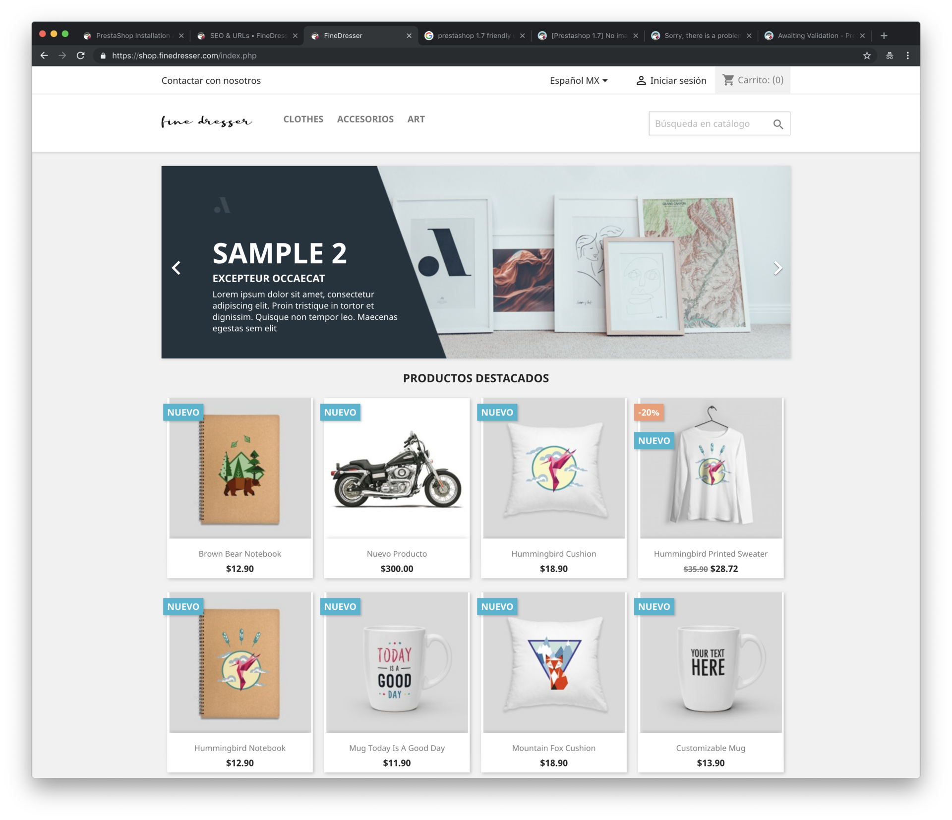

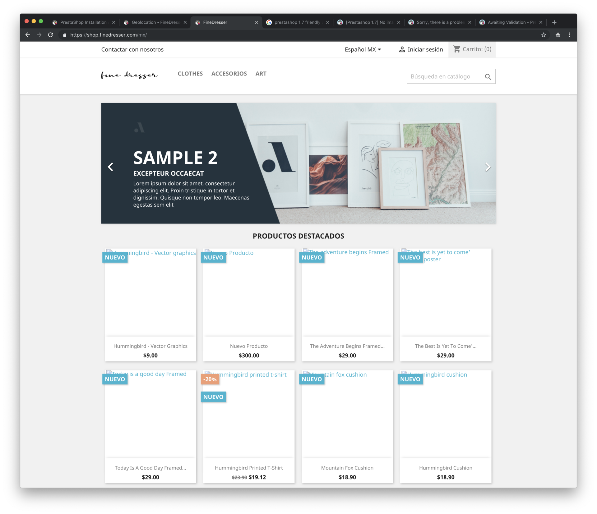

I have the very same issue!
After a fresh install of 1.7.4.4 all sample product images are not shown, Create a new product and also did not display the product photo.
If I switch and turned off friendly urls then the product images are shown also the new one I just added, but when I turn the friendly urls on again the images disappear again.
The links works good, I really want to use the friendly url for better SEO but I cannot make it works as expected.
Here is the store:  shop.finedresser.com  I let the Friendly URL on so you can see the bad behavior.
First photo is Friendly URL = YES
Second photo is Friendly URL = NO

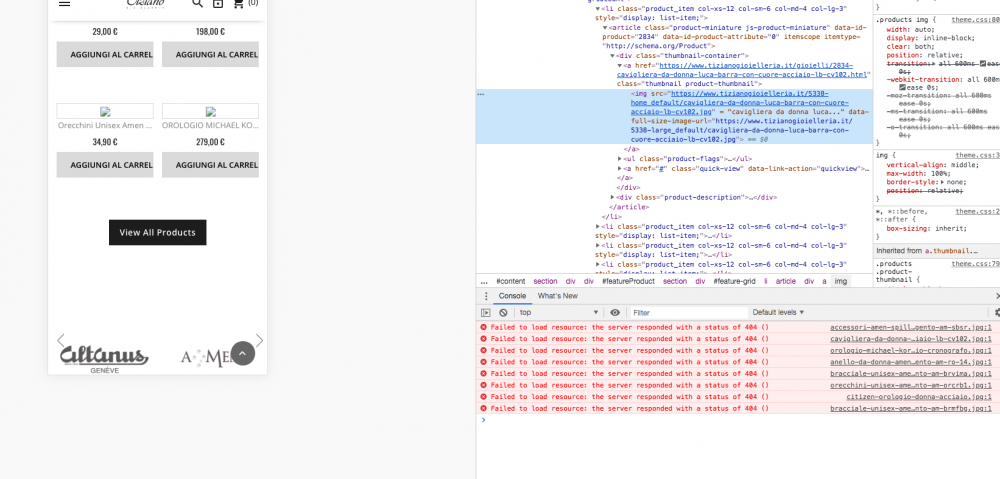

hey am also facing same problem its my .conf file any one help me to fix....
Quote
