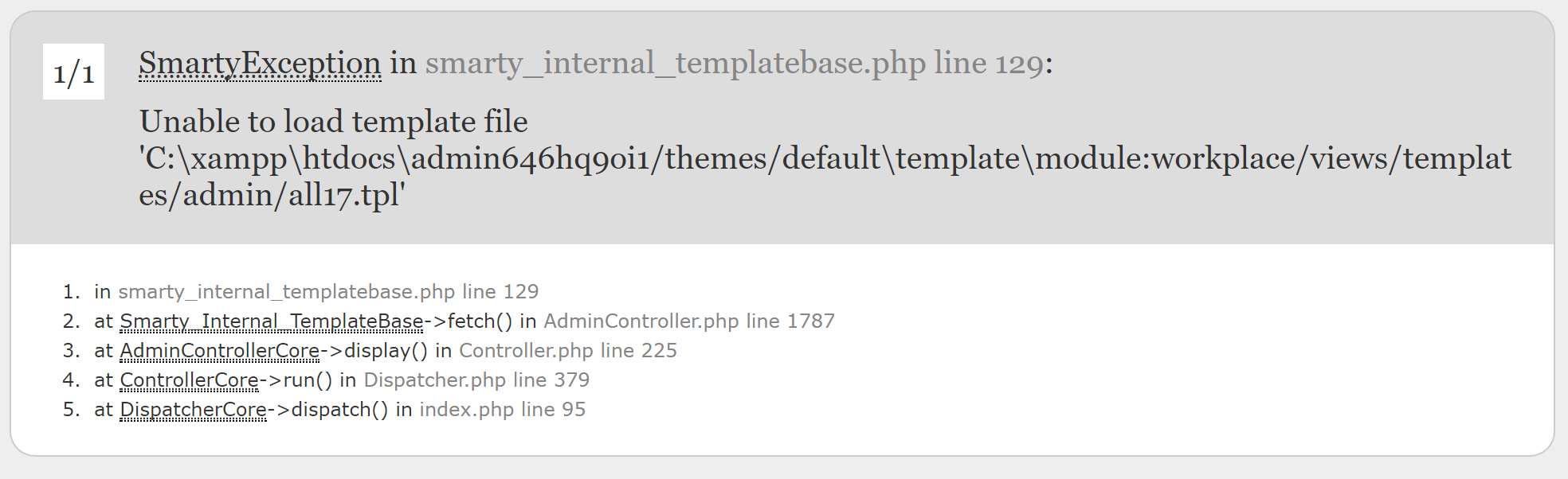

Dear prestashop developers,
A few days ago i tryed making my first prestashop module, and to be honest it's kind of a pain in the ass. but its a new challenge so i like it.
but there is a problem is can not get my head arround. and that is the setTemplate() function.
here is my code for my controller of the module :
<?php
class WorkplaceAllController extends ModuleAdminController
    public function __construct() {
        parent::__construct();
	public function init()
		parent::init();
	public function initContent()
		$this->setTemplate('all.tpl');
		return parent::initContent();
it isn't much, but i can not load the template 'all' it gets the template from : ../admin646hq9/themes/default/template/

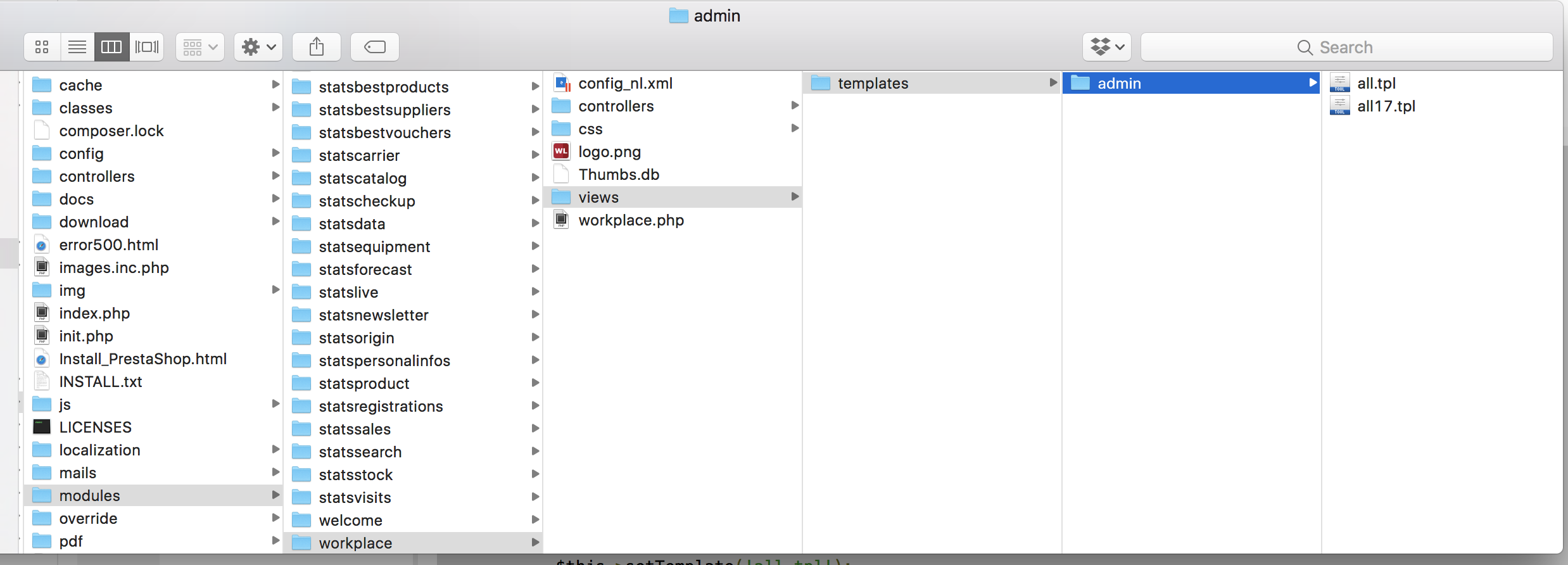

i would like it to get it from : ../module/My_module_name/views/templates/admin/
when i read the doc's online and watch tutorials this is the directory they use withoud a problem. how can i change it to the directory i want? becouse in this way i can not install the template with the module.

Try using this code:
<?php
		parent::init();
		$module_name = 'workplace';
		if(version_compare(_PS_VERSION_, '1.7', '>')) {
            $this->setTemplate('module:' . $module_name . '/views/templates/front/all17.tpl');
        }else {
For Prestashop 1.6.x.x: template all.tpl located here: /modules/workplace/views/templates/front/all.tpl
For Prestashop 1.7.x.x: template all.tpl located here: /modules/workplace/views/templates/front/all17.tpl
