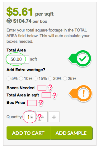

  2. Product Area Packs Calculator - I have a Length & Width Calculator Module to help the customer determine how much flooring is needed to purchase. But with JavaScript at the end all the variables are missing.

I'm pretty sure most people wont have the same issue as me. I fixed the issue though and figured I'd share just in case someone else reads this looking for answers.
I used the product.tpl page from the default theme so I could keep the default 3 column layout in my theme. However these two pages were coded differently so it was requesting different information. I copied most of my theme files into this new product.tpl page and only kept the primary block on the product page. After i did this and uploaded I was able to enable the non working modules.
