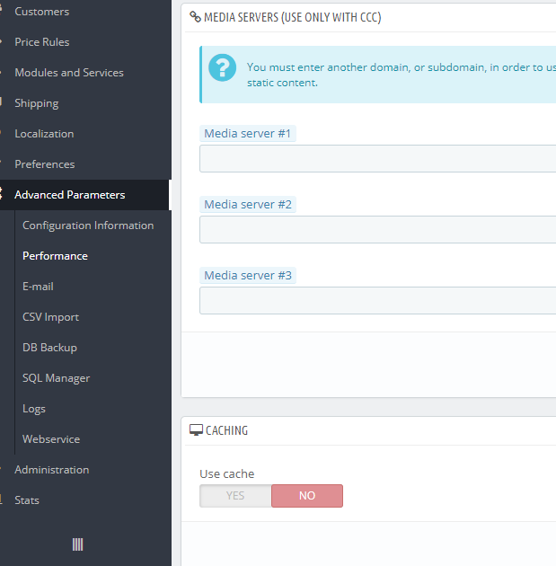

Same results you can accomplish by change settings in:
Administration > Advanced parameters > Performance > Ciphering > Algorithm > "Use the custom BlowFish class"
(switch from "Rijndael with mcrypt lib")

On the new install, I don't have the "ciphering" option in Advanced Parameters / Performance.
But have it on the old "shop"...
Copied the AdminPerformance controller from one (new) subdomain to the other (old) : still have the option...
And remember no cache, and cache cleared anyway...
