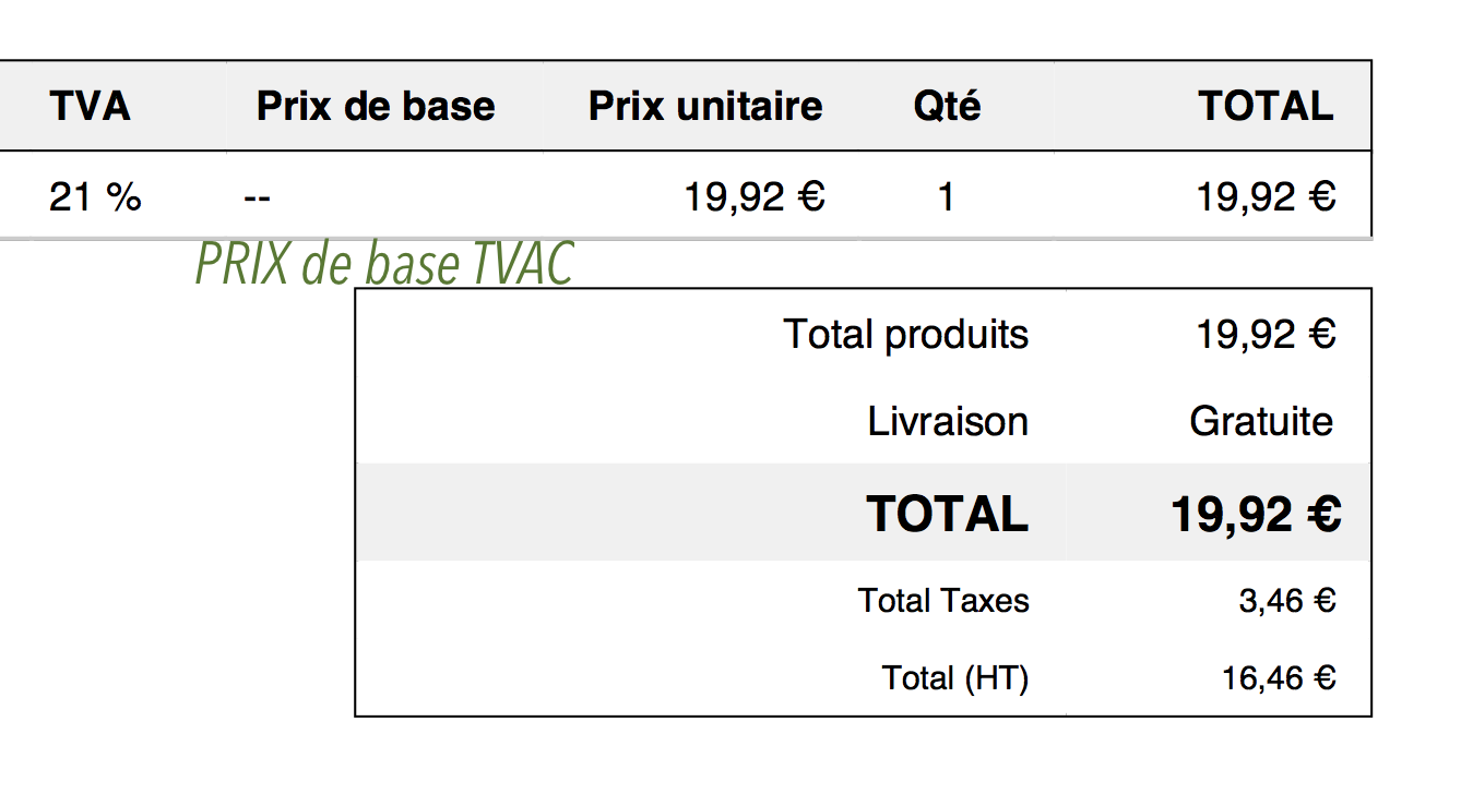

AlexVDB Posted May 14, 2017 Share Posted May 14, 2017 (edited) Bonjour, J'ai transformé la facture automatique en "reçu" en réduisant le nombre d'information sur la TVA. J'aurai besoin (en cas de remise sur un article) d'afficher le prix AVANT REMISE TVA COMPRISE. Je n'y parviens pas. Quelqu'un aurait-il un solution à ce problème? {if isset($layout.before_discount)} <td class="product left"> {if isset($order_detail.unit_price_tax_incl_before_specific_price)} {displayPrice currency=$order->id_currency price=$order_detail.unit_price_tax_incl_before_specific_price} {else} -- {/if} </td> {/if} <td class="product right"> {displayPrice currency=$order->id_currency price=$order_detail.unit_price_tax_incl_including_ecotax} {if $order_detail.ecotax_tax_excl > 0} <br> <small>[spam-filter]displayPrice currency=$order->id_currency price=$order_detail.ecotax_tax_excl}|string_format:{l s='ecotax: %s' pdf='true'[spam-filter]</small> {/if} Edited May 14, 2017 by AlexVDB (see edit history) Link to comment Share on other sites More sharing options...

BeComWeb Posted May 16, 2017 Share Posted May 16, 2017 Dans classes/pdf/HtmlTemplateInvoice.php, vers la ligne 165 foreach ($order_details as $id => &$order_detail) { // Find out if column 'price before discount' is required if ($order_detail['reduction_amount_tax_excl'] > 0) { $has_discount = true; $order_detail['unit_price_tax_excl_before_specific_price'] = $order_detail['unit_price_tax_excl_including_ecotax'] + $order_detail['reduction_amount_tax_excl']; } elseif ($order_detail['reduction_percent'] > 0) { $has_discount = true; $order_detail['unit_price_tax_excl_before_specific_price'] = (100 * $order_detail['unit_price_tax_excl_including_ecotax']) / (100 - $order_detail['reduction_percent']); } // Set tax_code $taxes = OrderDetail::getTaxListStatic($id); $tax_temp = array(); foreach ($taxes as $tax) { $obj = new Tax($tax['id_tax']); $tax_temp[] = sprintf($this->l('%1$s%2$s%%'), ($obj->rate + 0), ' '); } $order_detail['order_detail_tax'] = $taxes; $order_detail['order_detail_tax_label'] = implode(', ', $tax_temp); var_dump($order_detail); } die; A la fin de la boucle j'ai ajouté un var_dump() et un die() après la boucle. En faisant ça tu vas pouvoir debugger ce que contient chaque ligne de la facture et trouver quelle valeur correspond à ce que tu veux obtenir. Bien sûr une fois que c'est fait tu enlèves le var_dump() et le die() Link to comment Share on other sites More sharing options...
AlexVDB Posted May 17, 2017 Author Share Posted May 17, 2017 J'ai ajouté les ligne, mais j'ai toujours le même affichage sur la facture PDF. <!-- PRODUCTS --> {foreach $order_details as $order_detail} {cycle values=["color_line_even", "color_line_odd"] assign=bgcolor_class} <tr class="product {$bgcolor_class}"> <td class="product left"> {$order_detail.product_reference} </td> <td class="product left"> {if $display_product_images} <table width="100%"> <tr> <td width="15%"> {if isset($order_detail.image) && $order_detail.image->id} {$order_detail.image_tag} {/if} </td> <td width="5%"> </td> <td width="80%"> {$order_detail.product_name} </td> </tr> </table> {else} {$order_detail.product_name} {/if} </td> <td class="product left"> {$order_detail.order_detail_tax_label} </td> {if isset($layout.before_discount)} <td class="product left"> {if isset($order_detail.unit_price_tax_incl_before_specific_price)} {displayPrice currency=$order->id_currency price=$order_detail.unit_price_tax_incl_before_specific_price} {else} -- {/if} </td> {/if} <td class="product right"> {displayPrice currency=$order->id_currency price=$order_detail.unit_price_tax_incl_including_ecotax} {if $order_detail.ecotax_tax_excl > 0} <br> <small>[spam-filter]displayPrice currency=$order->id_currency price=$order_detail.ecotax_tax_excl}|string_format:{l s='ecotax: %s' pdf='true'[spam-filter]</small> {/if} </td> <td class="product center"> {$order_detail.product_quantity} </td> <td class="product right"> {displayPrice currency=$order->id_currency price=$order_detail.total_price_tax_incl_including_ecotax} </td> </tr> {foreach $order_detail.customizedDatas as $customizationPerAddress} {foreach $customizationPerAddress as $customizationId => $customization} <tr class="customization_data {$bgcolor_class}"> <td class="center"> </td> <td> {if isset($customization.datas[$smarty.const._CUSTOMIZE_TEXTFIELD_]) && count($customization.datas[$smarty.const._CUSTOMIZE_TEXTFIELD_]) > 0} <table style="width: 100%;"> {foreach $customization.datas[$smarty.const._CUSTOMIZE_TEXTFIELD_] as $customization_infos} <tr> <td style="width: 30%;"> {$customization_infos.name|string_format:{l s='%s:' pdf='true'[spam-filter] </td> <td>{$customization_infos.value}</td> </tr> {/foreach} </table> {/if} {if isset($customization.datas[$smarty.const._CUSTOMIZE_FILE_]) && count($customization.datas[$smarty.const._CUSTOMIZE_FILE_]) > 0} <table style="width: 100%;"> <tr> <td style="width: 70%;">{l s='image(s):' pdf='true'}</td> <td>{count($customization.datas[$smarty.const._CUSTOMIZE_FILE_])}</td> </tr> </table> {/if} </td> <td class="center"> ({if $customization.quantity == 0}1{else}{$customization.quantity}{/if}) </td> {assign var=end value=($layout._colCount-3)} {for $var=0 to $end} <td class="center"> -- </td> {/for} </tr> <!--if !$smarty.foreach.custo_foreach.last--> {/foreach} {/foreach} {/foreach} <!-- END PRODUCTS --> HTMLTemplateInvoice.php Link to comment Share on other sites More sharing options...
BeComWeb Posted May 17, 2017 Share Posted May 17, 2017 Désolé mais j'ai rien compris dans le fichier HTMLTemplateInvoice.php que tu joins il n'y a ni le var_dump() ni le die() tu postes une centaine de lignes du template de facture mais on ne sait pas ce qu'il faut chercher et surtout je doute que tu aies compris la manipulation que je voulais te faire faire var_dump() est une fonction de PHP qui permet d'afficher tout ce que contient une variable. die() est une autre fonction PHP qui stoppe brutalement toute l’exécution du code (en gros après un die() le reste du code n'est pas interprété). Si tu avais mis le die() la facture ne se générerait pas. Donc tu ne l'as pas mis. Lis la documentation de ces 2 fonctions pour mieux comprendre à quoi elles servent Link to comment Share on other sites More sharing options...
