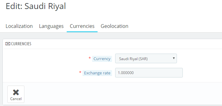

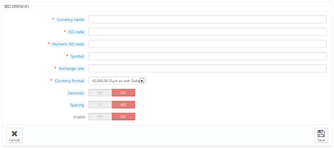

As you all know, in previous Prestashop versions like 1.6, you were able to fully customize your currency in your back office as you can see:
But currently, the new Prestashop 1.7 doesn't allow you to customize your currency in your own liking as you can see below:

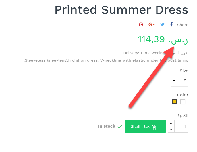

In my case, the price in my store looks like this:
There are a couple of things wrong about the default price/currency formatting for my ar-sa language.
1- We use decimals instead of commas (it should be 0.00 instead of 0,00).
2- We mostly round up the price meaning there's no need for decimals, so they have to give us the option to enable/disable decimals (it should be 0 instead of 0.00).
​3- We don't usually use letters in the currency, we use the word Riyal instead (just like Euro).
4- The currency is placed before the price, but it should be after the price (to the left).

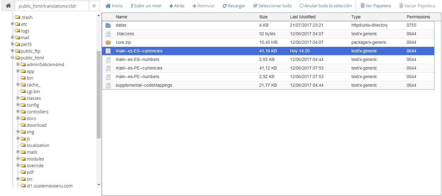

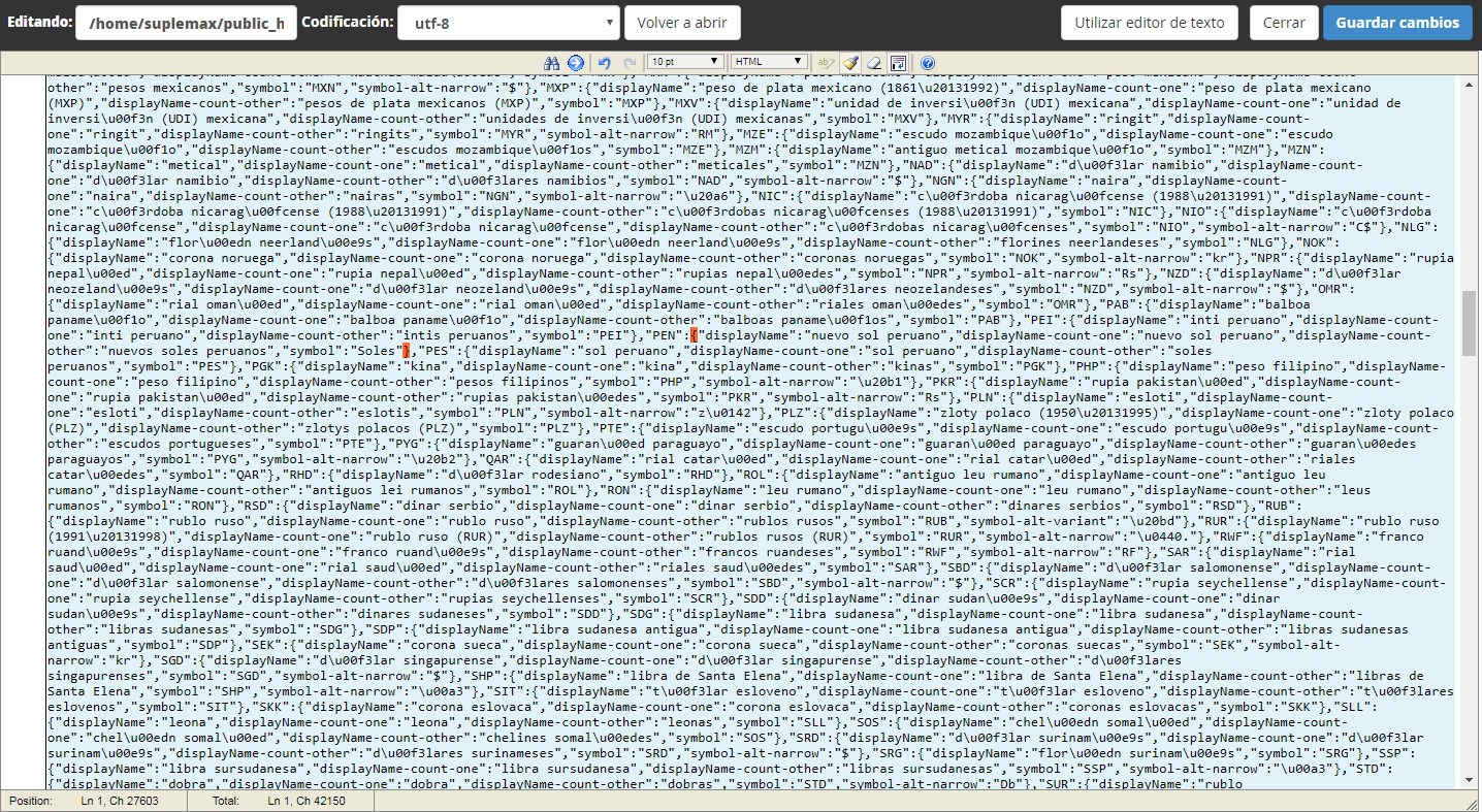

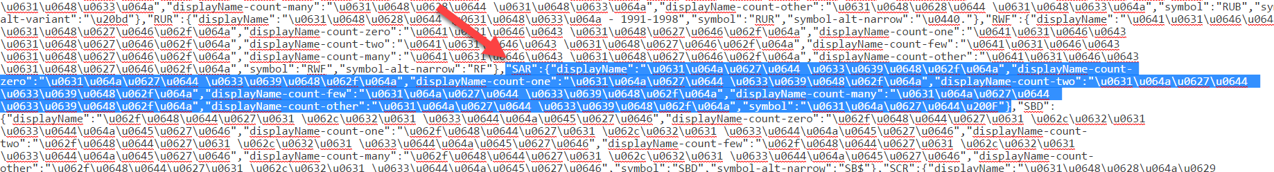

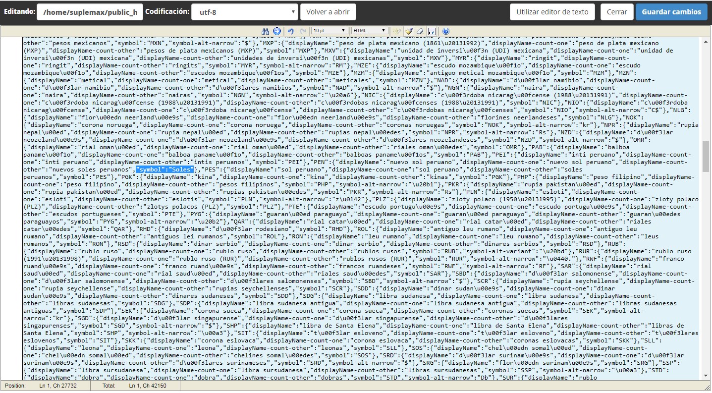

I found the following solution:
1) Enter cpanel and enter file manager
2) I followed this path (public_html / translations / cldr), and enter the file main - es - ES - currencies, I actually see two the first one I just wrote and this other main - es - PE - currencies , However enter the first as it is the language version that I am using in my store since in the second comes a mixture of Spanish with English, attached the first image.
3) Look for the symbol that was trying to change that in my case was the PEN and after a certain time I found it, it's a shame that I do not have an eagle eye, attached second image

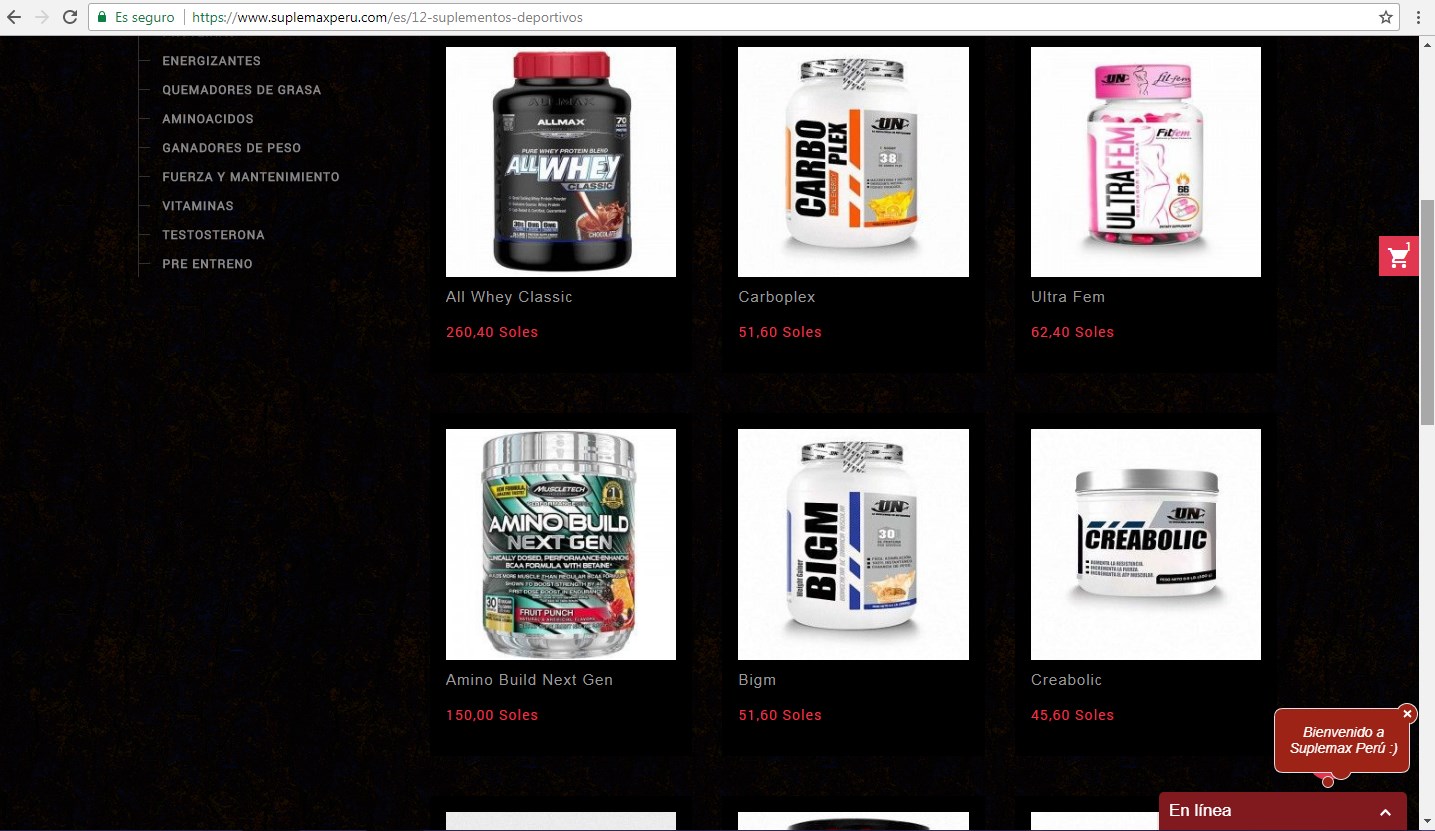

4) As my goal is to change the symbol that you see PEN say now that you say Soles, inside the bracket where I have selected in the image attached above look for this "symbol": "PEN" and now change it to "symbol ":" Soles "and I gave you save, attached third image
5) Finally it came to change, as you can see in the last image attached.
Note: on the main page of my shop the prices of the products does not appear the word Soles, before starting all this showed me indicating PEN but since I make the change appears in the rest of pages but not in the main page, for more Cache cleaning I have performed does not show it, attached image
It is for version 1.7.1.2 that I am currently using I imagine it will be the same for all other versions of 1.7

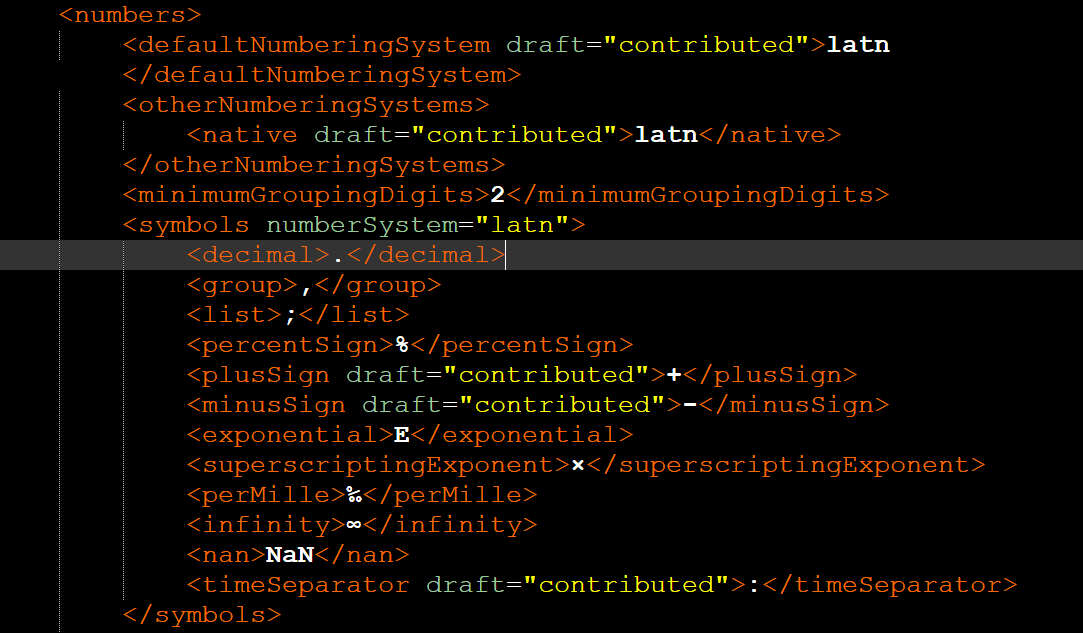

On 6/26/2018 at 2:55 AM, Yuriy said:
I have solved it by edit /translations/cldr/main--es-ES--numbers
I changed:
"symbols-numberSystem-latn":{"decimal":".","group":","
to
"symbols-numberSystem-latn":{"decimal":".","group":"."
In the current version of Prestashop 1.7.8.* you can find it in your corresponding language xml file in the following folder:
\localization\CLDR\core\common\main
