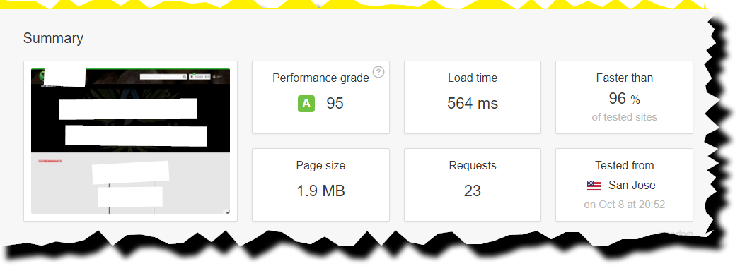

chronicrd Posted October 9, 2017 Posted October 9, 2017 How many products do you have?I have been working on a perfect (as close to perfect as possible for one of my client's sites) server setup for PS 1.7 for awhile now. I have gotten to the point where I am at 890 milliseconds on the first homepage (cache empty) and 555 milliseconds on the second loading (cached). My client has been bugging me to move from Magento for some time now and I have spent the past few months really trying to get as close to under a second as possible.We are using Cloudways as well. I have it configured a little differently in Cloudways (compared to stock) and then I am utilizing a couple of other services.Our shop has 1040 products and we are utilizing the Transformer theme.I wanted to spend sometime writing up a good guide for others who are using a similar setup, but I am not 100% done yet.If you are still interested, please let me know.I know there are many other factors to PS that I do not fully understand and I am not a PS pro. Nowadays, I am an SEO consultant that specializes in SEO for non-traditional industries. I haven't built any sites in years. I took on this project more for the challenge. What I am trying to say is that I might be missing some other factors outside of Pingdom for speed testing, so this may not be accurate. But it was still fun to push PS 1.7 this far.I just took this last test a second ago:I have been cloning and changing domains recently (waiting on an approval to change to the current Magento site's domain name), so I didn't want to give a URL that ended up going to nothing. Share this post Link to post Share on other sites More sharing options...
