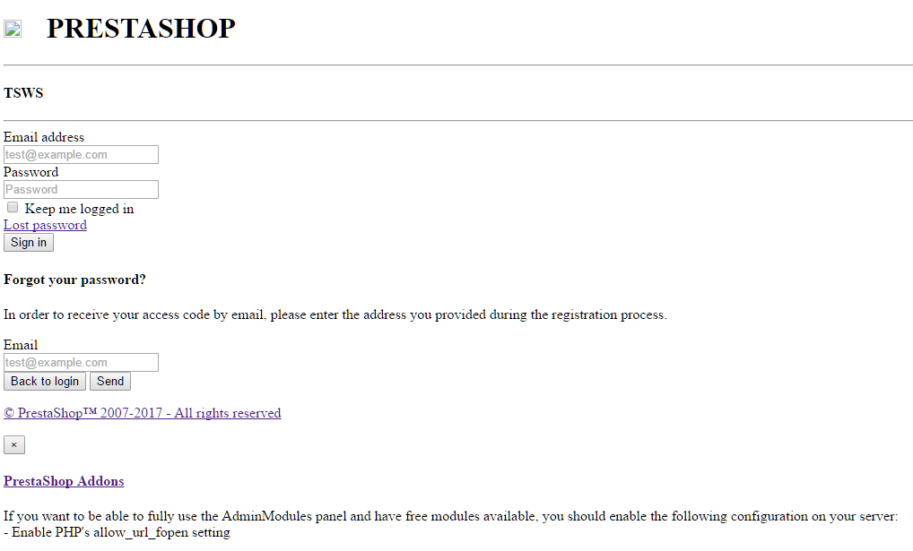

Migration failed. Back Office login screen is wrongly formatted (see attached pic) and I cannot login despite using the same credentials from Cloud to hosted server.

Ok I found out that the Back Office login page looks ok if I do shop.mydomain.com/admin instead of mydomain.com/shop/admin
Yet my login fails and when I try reset password the system is telling me that this account does not exist.

I fixed the URL's and removed .htaccess. The shop is now working but I can still not login in the Back Office. I tried resetting the password, or create a new account, but not ta avail.
Strangely when I go in the Forgot / Lost Password I keep getting:
There is one error.
  1. This account does not exist.
Edited by dacct (see edit history)
