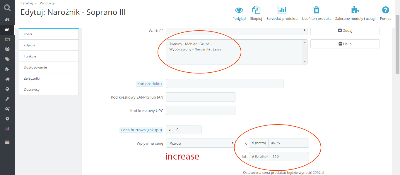

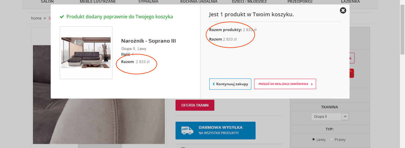

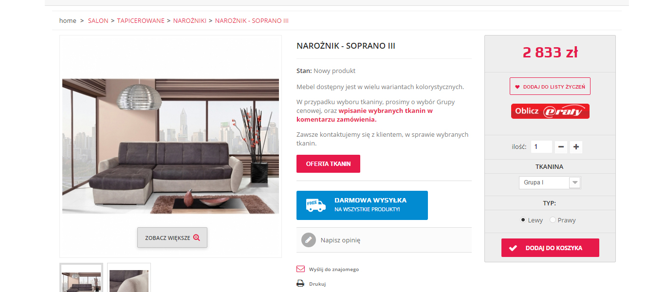

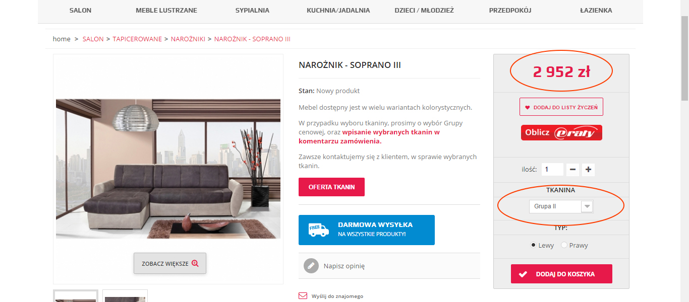

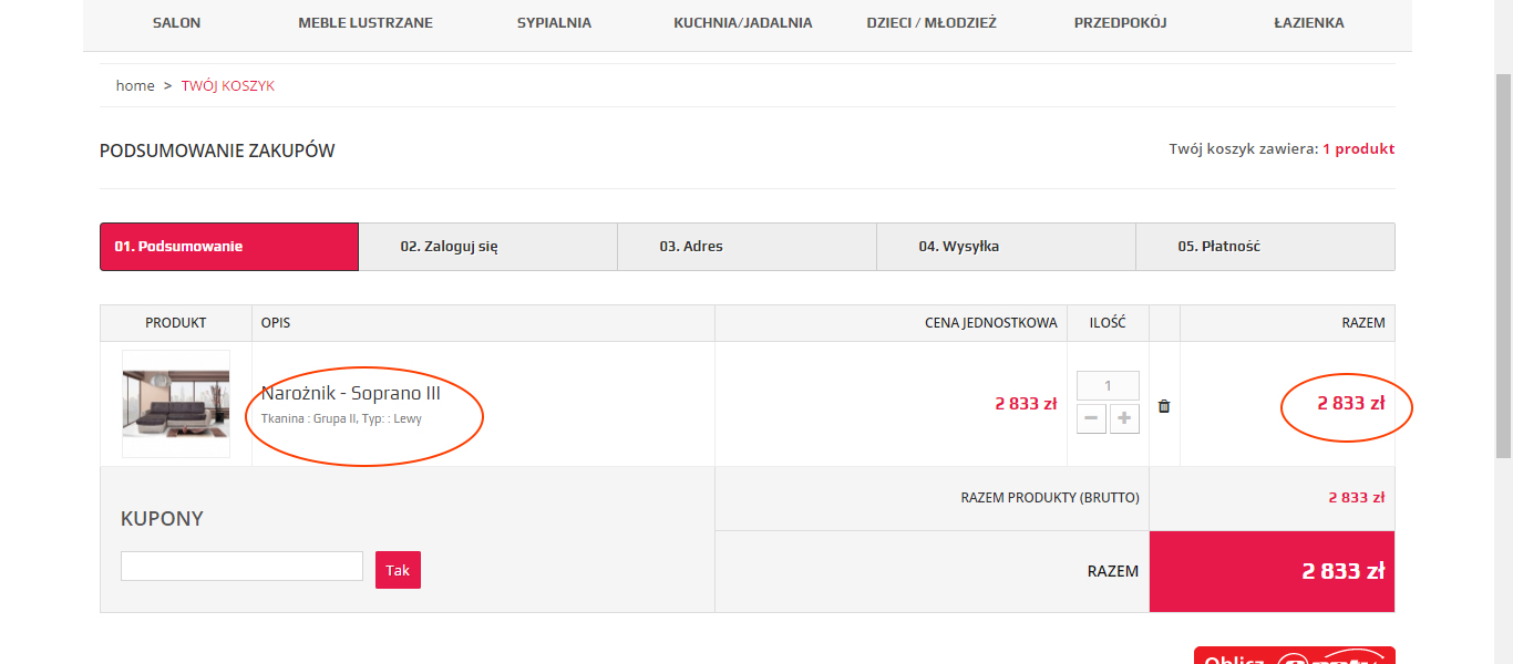

alan3k Posted February 3, 2017 Share Posted February 3, 2017 Hello, I have problem with attributes in prestashop 1.6.1.1 When I'm changing attribute on product page, price is changing. But if I'm trying to add to cart product with this combination, price is default. I have read a lot of topics, but I didn't found solution. Already tried: - Changing to default template. - Changing to original files: Product.php, ProductController.php and product.js Photos: If anyone have some advices, I will be glad for help. Link to comment Share on other sites More sharing options...

w3bsolutions Posted February 9, 2017 Share Posted February 9, 2017 Do you have any override in /override ? I tried doing some debugging and I believe the correct combination is being sent to the cart, however it is returning default combination. You can check adding a different from default combination to the cart, after you go to the cart and the combination/attributes are correct, but the price is that of the default combination. So this makes me think its a server side problem. Is there any reason you cannot update to the latest 1.6 version? 1 Link to comment Share on other sites More sharing options...
