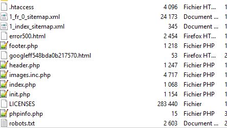

Baba deCode Posted December 16, 2016 Share Posted December 16, 2016 ce n'est pas normal... est ce que tu as des fichiers byzarre sur ton ftp style up.php ? Link to comment Share on other sites More sharing options...
Patrick_64 Posted December 16, 2016 Author Share Posted December 16, 2016 non que du classique Link to comment Share on other sites More sharing options...
