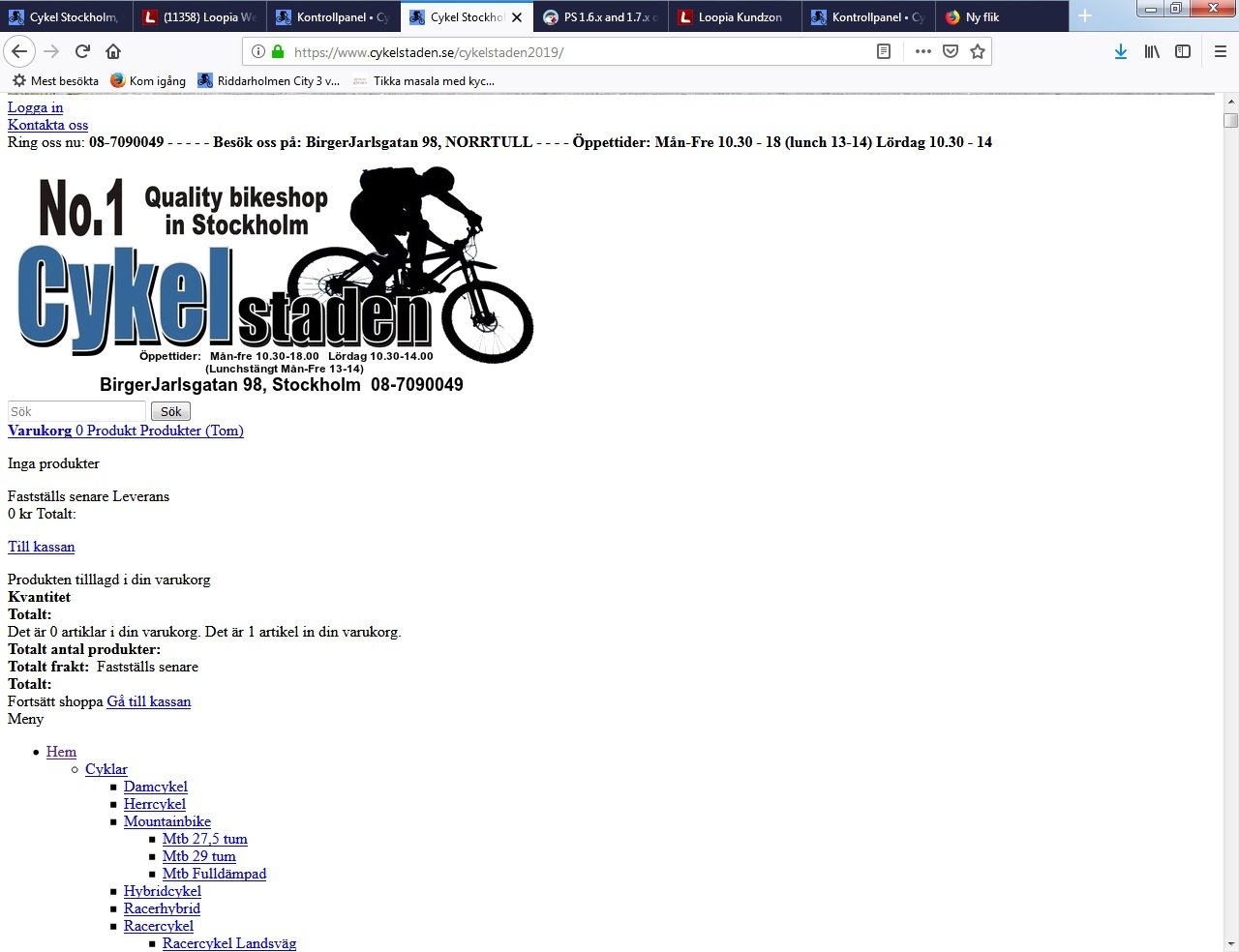

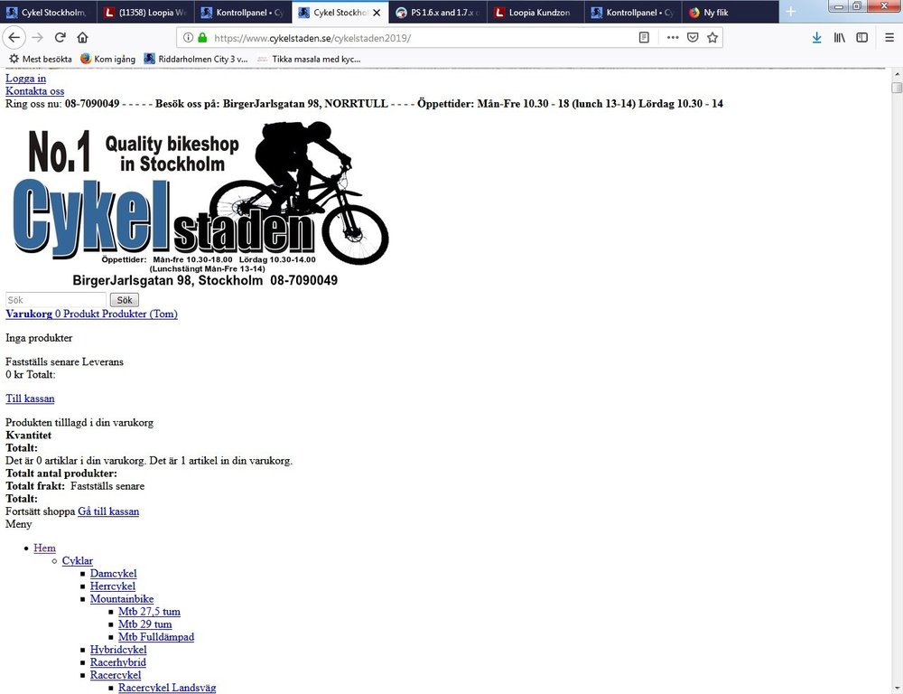

plutten22 Posted December 5, 2018 Share Posted December 5, 2018 Hi. I have now upgraded my site to 1.6.1.23 but it dos not work with php 7.1 Backoffice work but frontoffice dos not. I attache a picture. Regards Link to comment Share on other sites More sharing options...
bellini13 Posted December 5, 2018 Share Posted December 5, 2018 perhaps you have a custom theme or module that does not support it. enabled debug mode and see if that provides a helpful error Link to comment Share on other sites More sharing options...

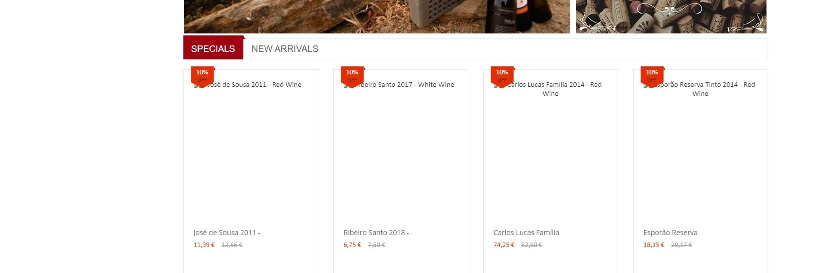

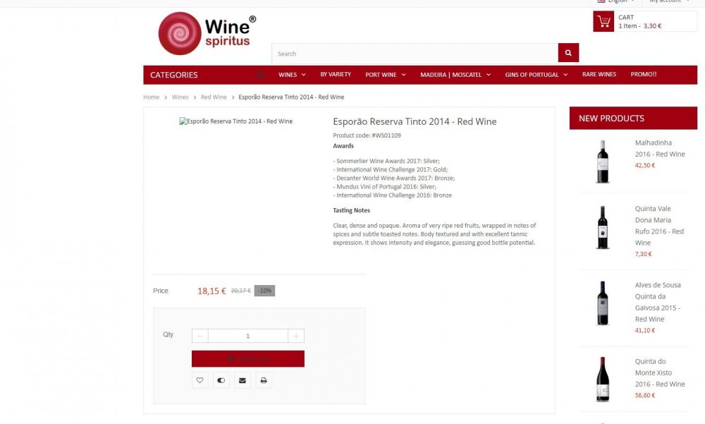

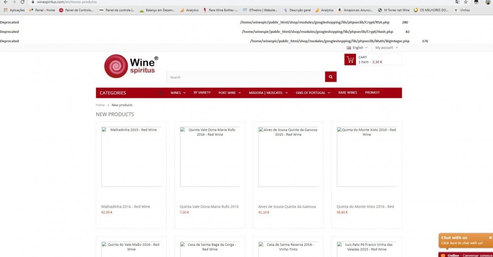

lagoacity Posted September 24, 2019 Share Posted September 24, 2019 Hello, I needed a help, I have a problem with the site where overnight the images of the site were all in error. We talked to the person who handled the accommodation and made the change to php because there had been an error and would have to change the php but then I got the images "no images". If I enter BackOffice in a product the images are there, but on the site they do not appear. How can I solve this situation? Prestashop version 1.6.1.7 PHP version: 7.1.32 https://www.winespiritus.com/ Through the link you can see the images of products that are not giving I look forward to a brief reply. Best regards, André Correia! Link to comment Share on other sites More sharing options...
