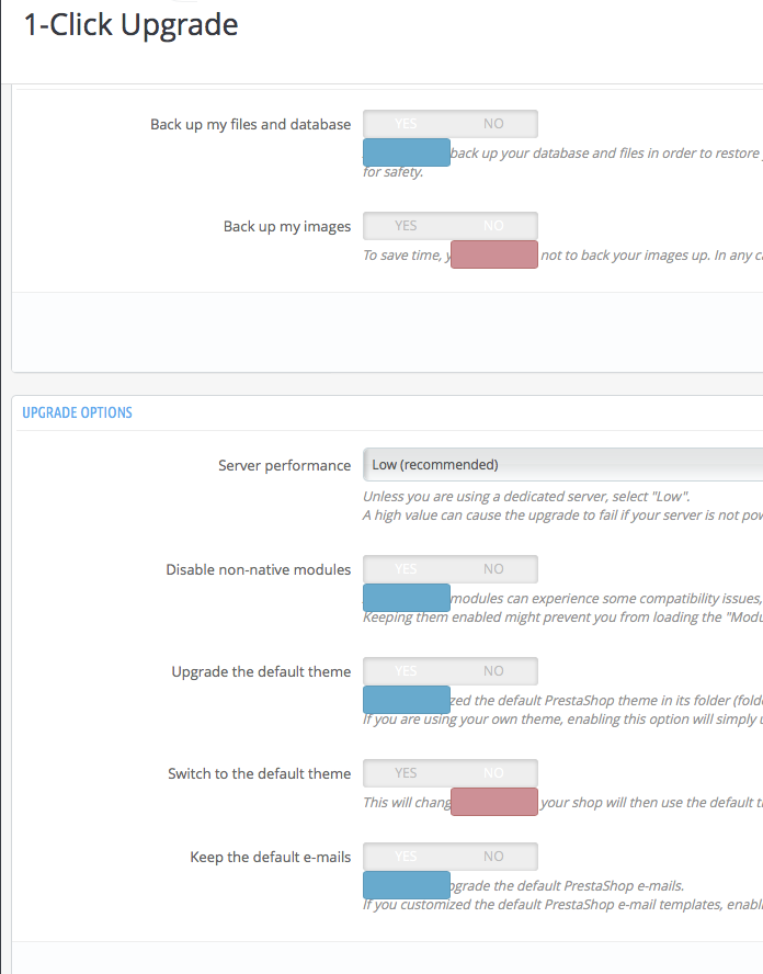

This is how I managed to upgrade to presta 1.7.0.5 (from 1.7.0.4):
1) Downloade the 1 Click Update module (version 2.0.4) -> https://addons.prestashop.com/en/data-migration-backup/5496-.html
I had Installed it in my shop.
2) Using Filezilla I went to shop -> admin -> autoupgrate
Here i saw that some files/folders had 0666 and 0777 permisions. I had changed the permisions to 0644 and 0755.
3) In admin shop i went to  1-Click Upgrade module
Start Your Update -> More Options (Expert Mode) -> Channel -> * Major release -> Save
Backup Options -> Back up my files and database -> No
                          -> Back up my images -> No -> Save
                           (I recomand doing a backup before, using CPanel/filezilla).
Upgrade options -> Server performance -> Low
                                Disable non-native modules -> No
                                Upgrade the default theme -> Yes
                                Switch to the default theme -> No
                                Keep the default e-mails -> No -> Save
Click on -> Upgrade prestashop now
It took a few minutes, and te upgrade was succesfull.
Thank you very much, it helped me a lot!
