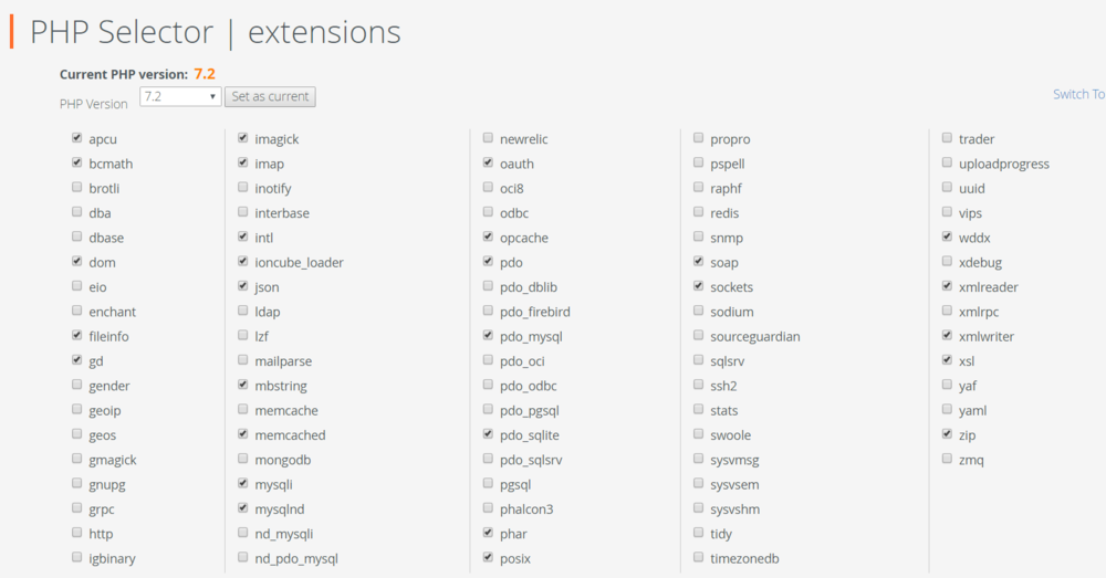

satkauskas Posted May 9, 2018 Share Posted May 9, 2018 (edited) Enabling opcache solved that error. Its a php accelerator. Image shows mine PHP extensions enabling I use 7.2 with these modules enabled older php, please enable mbstring also, and apcu, Edited October 1, 2018 by satkauskas (see edit history) 4 Link to comment Share on other sites More sharing options...
