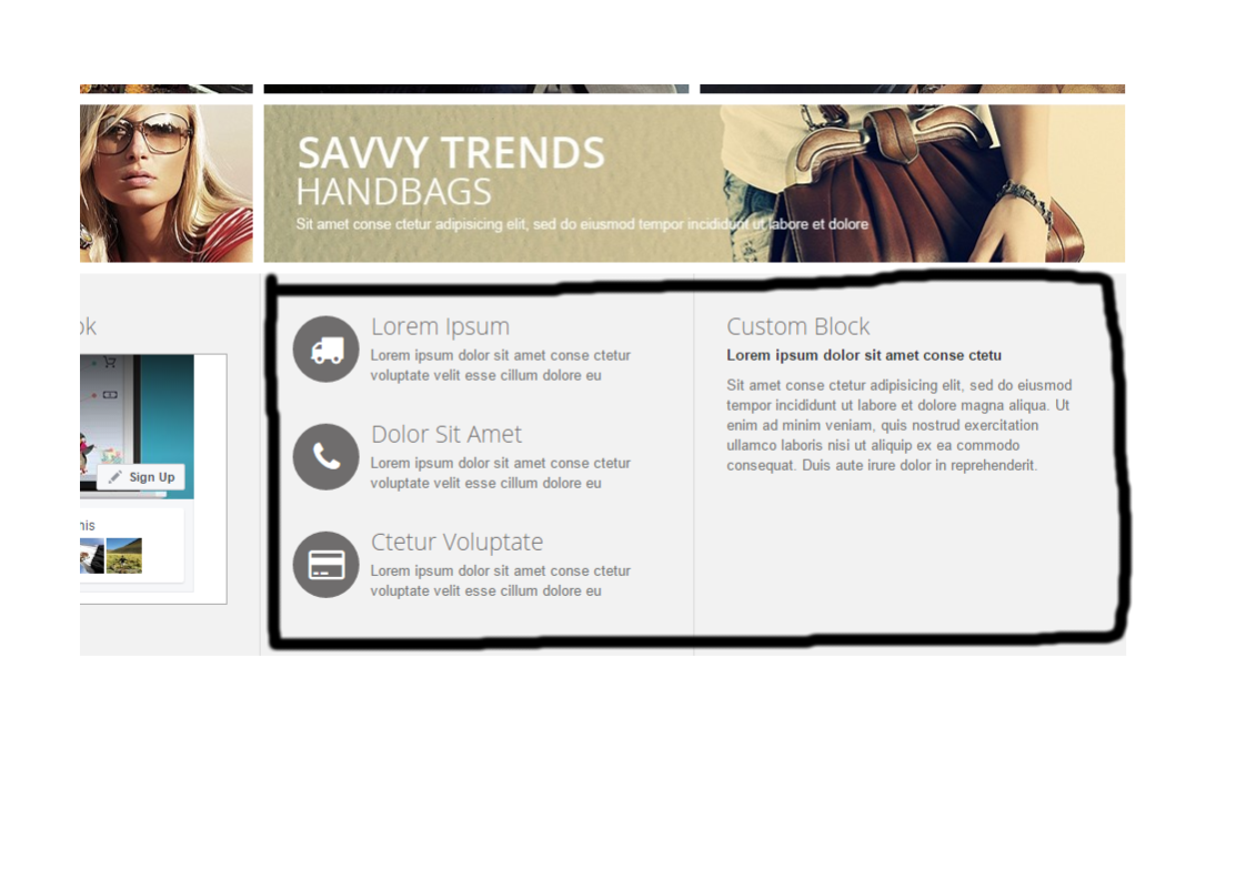

1. I installed 1.6.1.7 version prestashop.
2. when i configure the shop in backoffice, I disabled a standard module which shows a block extra information on frontpage in "Module and services" , see attached files.
3. now the backoffice showing ,
[PrestaShop] Fatal error in module file :/var/www/vhosts/my root catalog /modules/statsdata/statsdata.php: syntax error, unexpected '['
and i am not able to access  "modules and services"  also frontpage showing "page isn’t working"
can you give me some advices?
