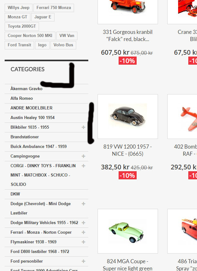

SOLVED - How do I change top menu on a left menu?
e30_dk

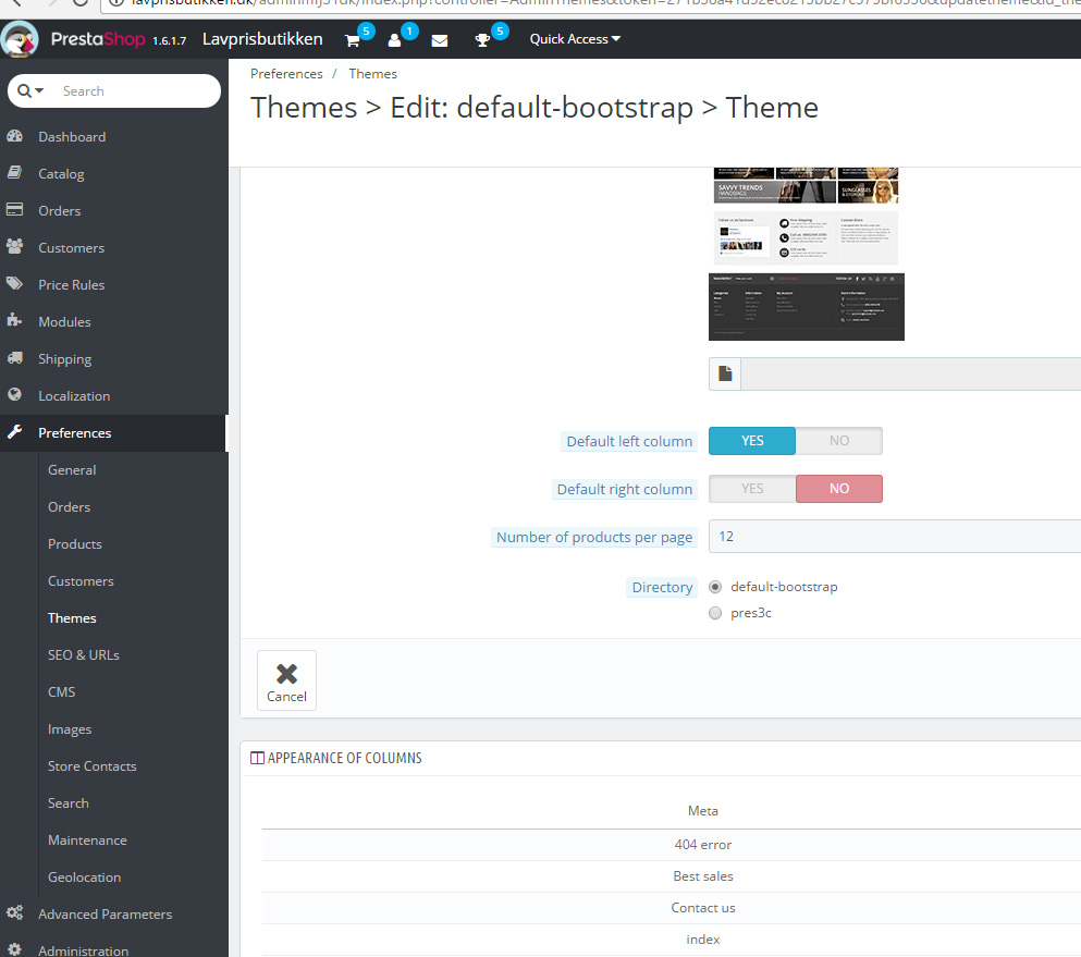

Than probably you simply deleted the block category module from the hook (with live editor?). In this case deinstall lthe module block categories and install it again, it will hook to the left column again.
OR hook the module manually: Tab modules -> positions -> move/add a module. Than from the list select the module blcokcategories and hook it again to leftColumn hook.

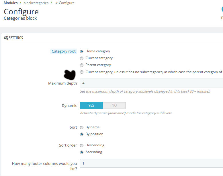

select them on the configuration of the module (you can take your other configuration shop as sample, take a look into the module configuration). Don't know how much depth you are using, but you should consider to change the maximum depth:
The screen attached is for if your MAIN categories are all added to Home, which is standard. If you made some change, perhaps it will not work.... I've seen this by some users not knowing what they are doing...
