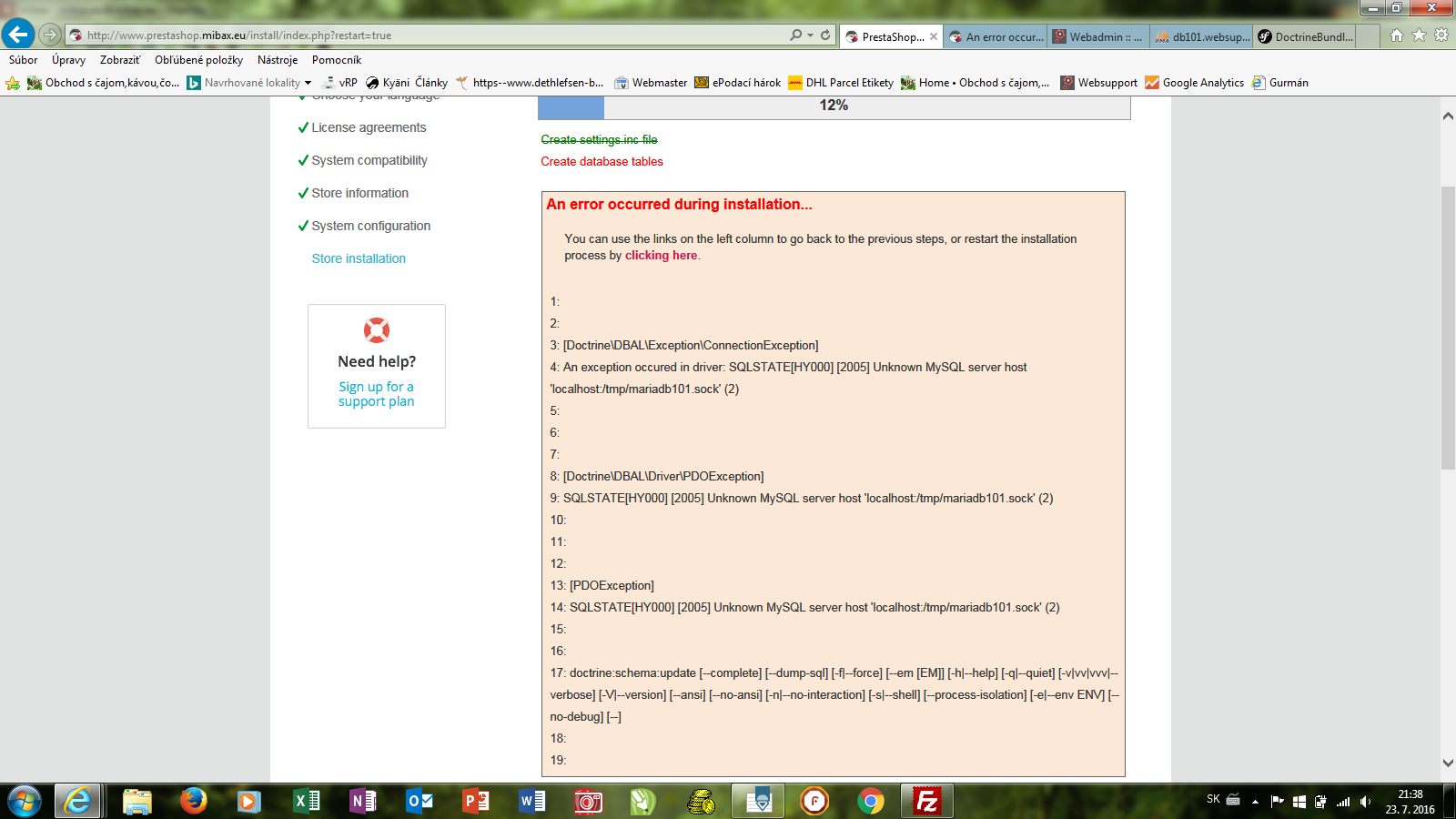

goodish Posted July 23, 2016 Share Posted July 23, 2016 Error during instalation 1.7 beta2. Clear instalation... Problem with Syphony:::? Can You help me? The picture of the message in the attachment. Link to comment Share on other sites More sharing options...
selectshop.at Posted July 23, 2016 Share Posted July 23, 2016 The problem is on your databasde server: the server is either not running, or not running on the specified port, socket or pipe. Contact server administrator (or read here: https://mariadb.com/kb/en/mariadb/troubleshooting-connection-issues/ ) AND try to use mySQL database instead of mariaDB. Link to comment Share on other sites More sharing options...
