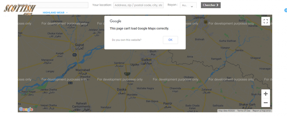

babyewok Posted June 27, 2016 Share Posted June 27, 2016 The store map does not work and I get this error: Google Maps API error: MissingKeyMapError https://developers.google.com/maps/documentation/javascript/error-messages#missing-key-map-errorhttp://maps.google.com/maps/api/js?sensor=true®ion=GBLine 32 Using default istallation of ps 1.6.1.6 Link to comment Share on other sites More sharing options...
babyewok Posted June 28, 2016 Author Share Posted June 28, 2016 Has anyone else expeirenced this problem? Link to comment Share on other sites More sharing options...

evomark Posted July 4, 2016 Share Posted July 4, 2016 I also have this issue. "Oops! Something went wrong. This page didn't load Google Maps correctly. See the JavaScript console for technical details." Did someone found a solution? Thanks. Link to comment Share on other sites More sharing options...
evomark Posted July 4, 2016 Share Posted July 4, 2016 Yes, these are the errors and warnings. I'm using 1.6.1.6. The error was also on 1.6.1.5... Google Maps API error: MissingKeyMapError https://developers.google.com/maps/documentation/javascript/error-messages#missing-key-map-error Google Maps API warning: NoApiKeys https://developers.google.com/maps/documentation/javascript/error-messages#no-api-keys Google Maps API warning: SensorNotRequired https://developers.google.com/maps/documentation/javascript/error-messages#sensor-not-required Link to comment Share on other sites More sharing options...

chirag_0110 Posted July 28, 2016 Share Posted July 28, 2016 (edited) Hi All, Finally found solution for google map searching issue. We just need to enable following APIs from Google Console. https://console.developers.google.com/apis/library. Google Maps JavaScript API Google Maps Geocoding API Google Maps Geolocation API You can see attached screenshot for better under stand. Please do this. It will resolve your issue. Enjoy :) Please make this topic as solved if it resolve your issue. Edited July 5, 2017 by chirag_0110 (see edit history) 5 Link to comment Share on other sites More sharing options...
nnd.newbie Posted July 29, 2016 Share Posted July 29, 2016 We just need to enable following APIs from Google Console. https://console.developers.google.com/apis/library. Google Maps JavaScript API Google Maps Geocoding API Google Maps Geolocation API It works for me. Thanks. Link to comment Share on other sites More sharing options...

zukkk Posted November 23, 2016 Share Posted November 23, 2016 just use this code: replace this: <script src="http://maps.googleapis.com/maps/api/js"></script> something like this in your contact tpl file with this: <script src="http://maps.googleapis.com/maps/api/js?key=BIzaSyA1gvGcwg6OPMaLsSutIecjkIXrABV3AoF"></script>; where after js?key= here you should put your google api key. https://developers.google.com/maps/documentation/javascript/get-api-key Link to comment Share on other sites More sharing options...
serdib Posted December 2, 2016 Share Posted December 2, 2016 (edited) For everyone! Don't forget to insert your API key also to /controllers/admin/AdminOrdersController.php Around line 340 (see screenshot) This will fix API warnings in Backoffice. And also remove &sensor=false code. Edited December 2, 2016 by serdib (see edit history) 1 Link to comment Share on other sites More sharing options...

daniel.pontigo Posted March 10, 2017 Share Posted March 10, 2017 Newly detected domains require an API key from now on. That kinda sucks :/ Here's the announcement: http://googlegeodevelopers.blogspot.nl/2016/06/building-for-scale-updates-to-google.html You will now need to visit your Google API Console, request an API key for the Google Maps JavaScript API, and change the file /controllers/front/StoresController.php Somewhere around line 289, you'll find the following: codeblock1.txt With your API key (example: POjjo83h3h379020323Hp7sY9bHB6U), change this into: codeblock2.txt and Google Maps should be working again. Hi: I set the code. but still having the same problem, can you help me please? this is mi code : if (!Configuration::get('PS_STORES_SIMPLIFIED')) { $default_country = new Country((int)Tools::getCountry()); $this->addJS('https://maps.googleapis.com/maps/api/js?key=AIzaSyAlE4X4vPPPLdE69X3xUboAKlyYZGY-Sow'); this is my web site: www.meridaestablecimientos.mx and this is my api credentials: Clave de API AIzaSyAlE4X4vPPPLdE69X3xUboAKlyYZGY-Sow Nombre Restricción de claveLa restricción de claves te permite especificar qué sitios web, direcciones IP o apps pueden usar esta clave. Más información NingunoURL de referencia HTTP (sitios web)Direcciones IP (servidores web, trabajos cron, etc.)Apps de AndroidApps de iOS Aceptar solicitudes de estas URL de referencia HTTP (sitios web) (Opcional) Usa asteriscos como comodines. Si dejas esto en blanco, se aceptarán las solicitudes de cualquier URL de referencia. Asegúrate de agregar URL de referencia antes de usar esta clave en producción. www.meridaestablecimientos.mx I don´t know what I´m doing wrong, please help me! Link to comment Share on other sites More sharing options...

w3bsolutions Posted June 6, 2017 Share Posted June 6, 2017 Since PS 1.6.1.14 it is possible to enter the API key in Preferences > General So no need for overrides anymore. 1 Link to comment Share on other sites More sharing options...
