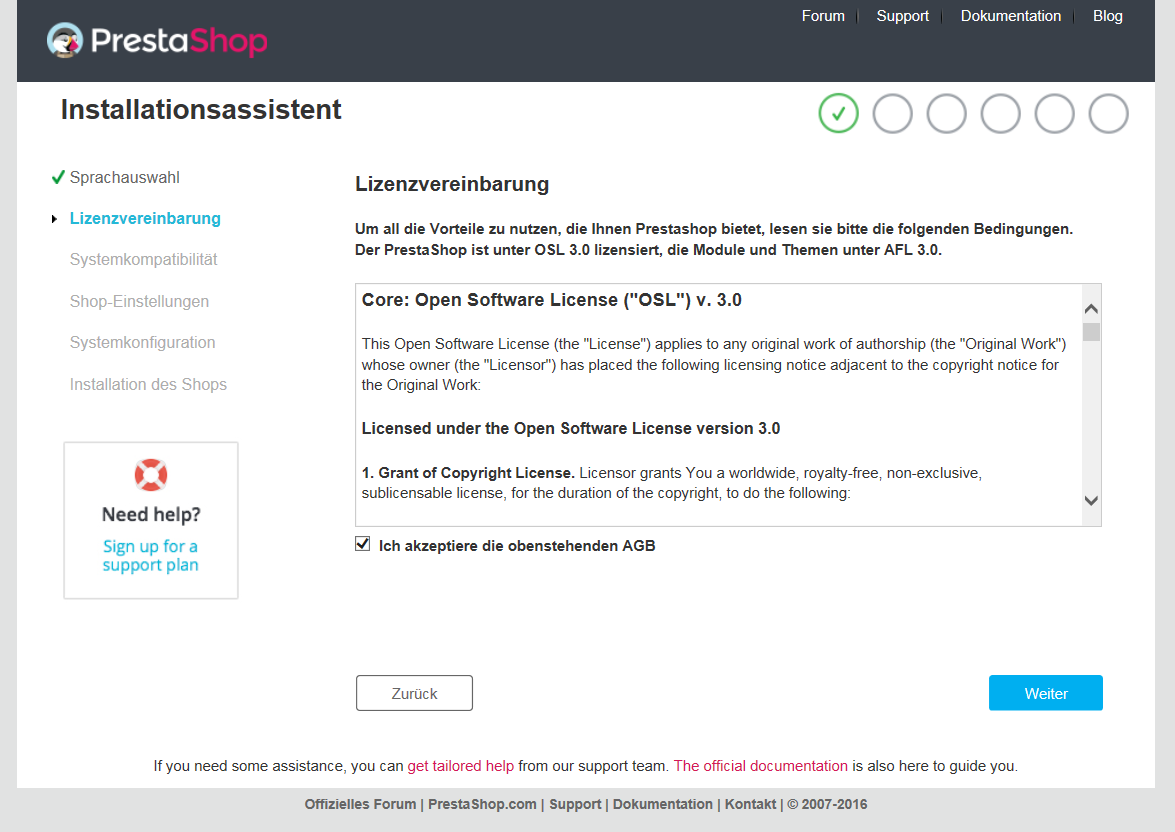

Issue Installation Prestashop - Loop at the 2nd Step (Licence)
Hello everybody,
I have freshly uploaded the files of prestashop 1.6.1.6 on my server and tried to install prestashop.
Unfortunately, I get the following issues:
Step 1: Language ; Whatever I choose in the dropdown menu, the language doesn't change. Even if I upload the french package, I get the german version (I'm living in Germany) and I want to change it to french, english, mandarin, the page loads again... in german. But well, I can still click on "Next" and go to Step 2. :huh2:
Step 2: I check "I accept...", the button "Next" becomes blue but when I click on it, the page loads again and stays in the second step (licence). :wacko:
Did somebody already experience this issue before ?
I have tried to install prestashop using the command-line script index_cli.php but it seems that the tables aren't created in the database, even if I don't get any issue when I give the command with the necessary parameters.

Hmm, my guess is some problem with where PHP stores session state, as the PrestaShop web installer uses sessions to save/restore state from step to step.
What is the setting of the PHP configuration variable session.save_path?
Does the directory it points to exist?
And is the directory writable by the user set in your php-fpm config?

session.save_path with no value is normally not a good thing, and the error reporting in PHP is a bit dodgy in this area. I think it defaults to /tmp which is normally not what you want, especially in shared hosting environments.
Check this one:
http://blog.outsourcing-partners.com/2012/05/php-sessions-not-working-correctly-tips-and-tricks/
Also I notice you're running with PrestaShop in a subdirectory (chocolatsanssucre), but your nginx config is inconsistent about this, sometimes it uses the subdirectory and sometimes not. Please check the link that mdekker included further up for the correct nginx config.

It was exactly the issue. Session Cookies weren't drop correctly, I have defined a path in my php.ini file and have double checked the configuration of my server. Now it works !
