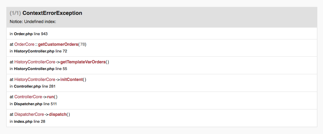

When I purchase and confirm a order by Bank wire payment, an order is created but with Paytpv payment method, order is not created and the products are still exist in the cart when the user is no registered, but if is a registered user give me this error:
1420098847_ScreenShot2019-07-23at13_51_45.thumb.png.4cd26cf69dbc5b91584fdd8d32e9264d.png
I have debug mode on,  i have already tried with debug mode off and still have the same issue.
