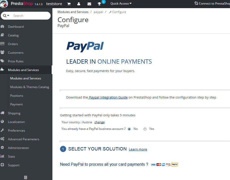

However, my cloud testshop configuration (btw. still not updated from 1.6.1.1 by service team) from today still reports:
OpenSSL support enabled
OpenSSL Library Version OpenSSL 0.9.8o 01 Jun 2010
OpenSSL Header Version OpenSSL 0.9.8o 01 Jun 2010

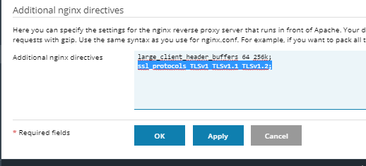

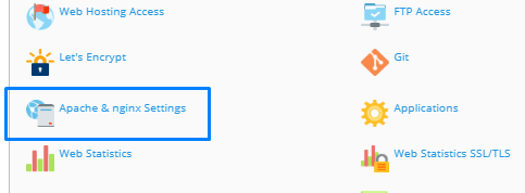

Hello,
  • Open your server panel (Plesk),
  • Go to domain detail page,
  • Find and click the Apache & Nginx Settings,
  • Paste:
    # ssl_protocols TLSv1 TLSv1.1 TLSv1.2;
  • and Save it.
  • That's it.
Share this post

35 minutes ago, espacious said:
Also thanks for your "how to" but i think i already have TLS1.2 enabled, as you can see in the screenshot or am i wrong?
Registered Stream Socket Transports tcp, udp, unix, udg, ssl, sslv3, tls, tlsv1.0, tlsv1.1, tlsv1.2
I'm pasting also the email i got from support team if it helps someone:
But you also have ssl, sslv3, tls and tls1.0 enabled.  all of which should be disabled as they are no longer secure protocols.  also with them enabled, paypal may be defaulting to them

On 5/8/2019 at 10:52 AM, SahinSOLMAZ said:
Hello,
  • Paste:
  • and Save it.
  • That's it.
SahinSOLMAZ seems working OK, Thanks to all!
