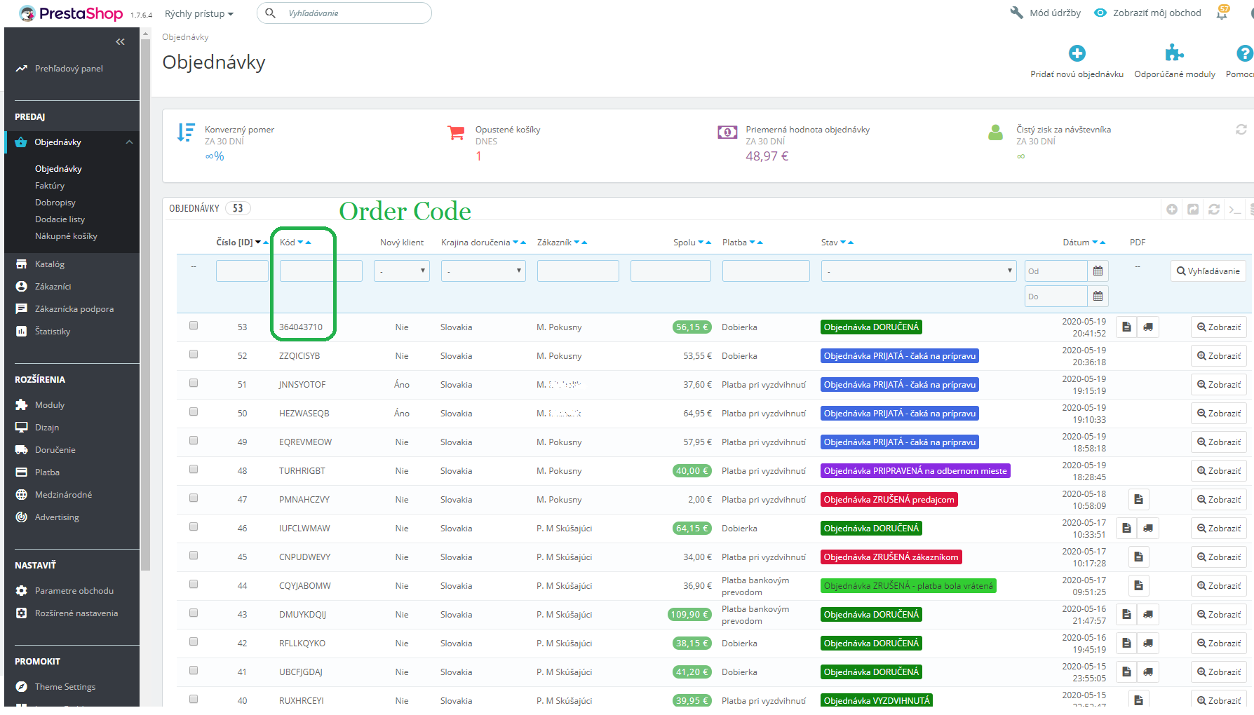

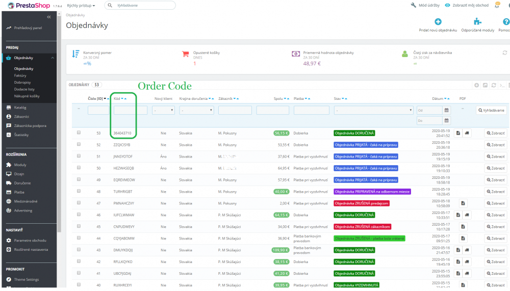

Martin Mi Posted May 20, 2020 Share Posted May 20, 2020 I can confirm this is working well in PrestaShop 1.7.6.4 as visible in the the picture below. Order Code gets changed during generation and displayed as a random number fine everywhere (email templates, orders, website confirmations, customer account, etc..) Best Regards, Martin Mi E-shop & E-commerce Agency www.dataquo.eu Link to comment Share on other sites More sharing options...
muynck Posted May 20, 2020 Share Posted May 20, 2020 7 hours ago, Martin Mi said: I can confirm this is working well in PrestaShop 1.7.6.4 as visible in the the picture below. Order Code gets changed during generation and displayed as a random number fine everywhere (email templates, orders, website confirmations, customer account, etc..) Best Regards, Martin Mi E-shop & E-commerce Agency www.dataquo.eu Looks good! Thanks for the feedback! Do you have recommendations for features? Link to comment Share on other sites More sharing options...

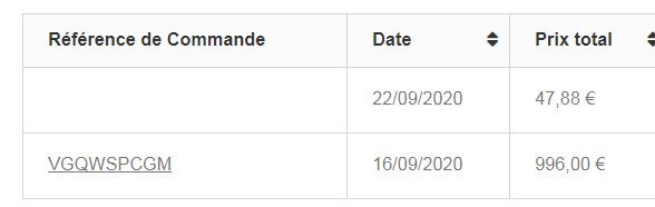

Pat13160 Posted September 22, 2020 Share Posted September 22, 2020 Hello, I installed the suggested version. The order numbers are not displayed !! In Admin: Format: do you have an example? Preview -> no information My Prestashop version: 1.6.1.27 Big thanks Link to comment Share on other sites More sharing options...
muynck Posted September 23, 2020 Share Posted September 23, 2020 @Pat13160 The field should be filled with variables, not absolute numbers. {$cart->id:%d} would, for example, put the cart id there. Can you give an example reference outcome, and explain what you want? Thanks! Link to comment Share on other sites More sharing options...
