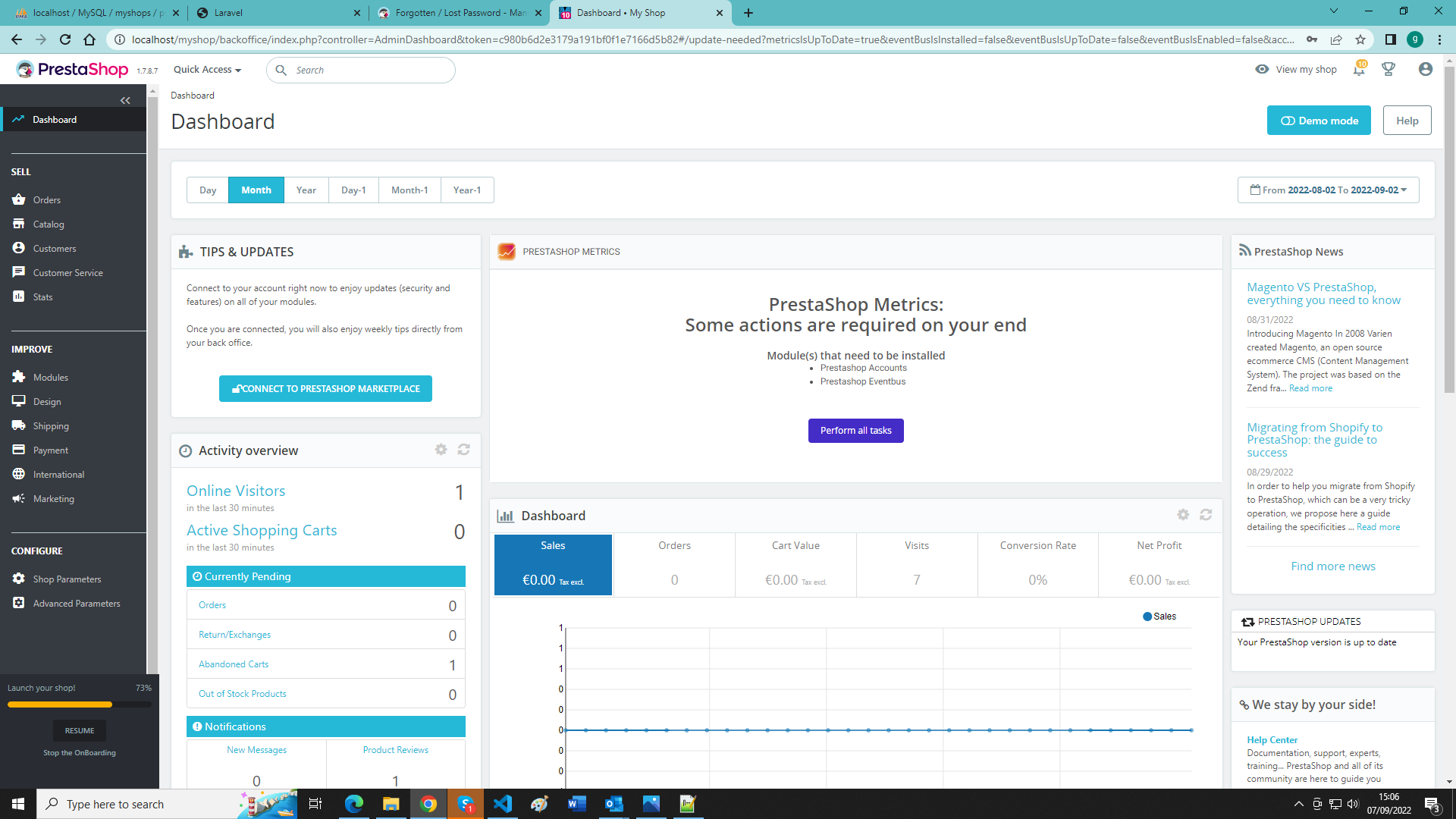

mehnoor Posted September 7, 2022 Share Posted September 7, 2022 (edited) Hello All, I had lost my password too, I am using a local host. What I did was: (solutions) 1. I open classes/employee.php 2. add line 329 : echo $crypto->hash($plaintextPassword); exit; 3. Go on the browser Put your email and password, don't click login 4. right click, choose inspect, choose responses, and copy the data in responses 5. Paste it in PHPMyAdmin, [your database name]/ps_employee in passwd, and press enter to save 6. Now go on browser and click on the login 7. Works like magic ~Mehnoor Edited September 7, 2022 by endriu107 (see edit history) 1 Link to comment Share on other sites More sharing options...
ClassyDevs Posted September 8, 2022 Share Posted September 8, 2022 Hello @mehnoor 's solution is great. I can make it simpler for you. Start from number 5 and paste the below text on the password field of your [your database name]/[DB_PREFIX]employee table $2y$10$Z2y3bYcBksYiGkYReov8Iu/xZ6oJJmRtdsoJ5DK7NjniF1rfg9Ukm The above encoded code represents password: 123456789 Log in and then you will be able to change the password. Regards ClassyDevs Link to comment Share on other sites More sharing options...
