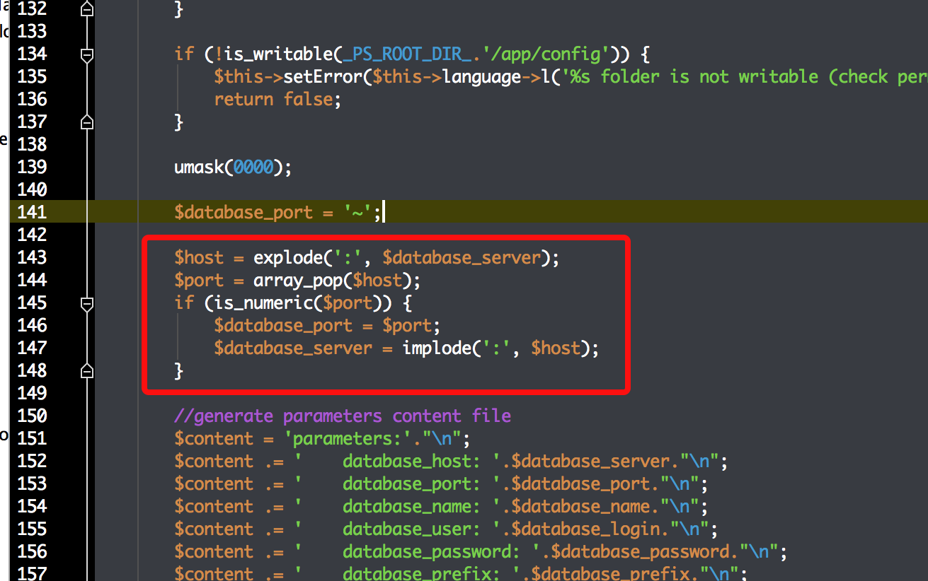

Hello guys,
trying to install the 1.7 Alpha 4 but getting the SQL error command doctrine:schema:update, please check your app/config/parameters.yml file
I comment the lines 224-227 of /install/models/install.php and it worked (so far...).
