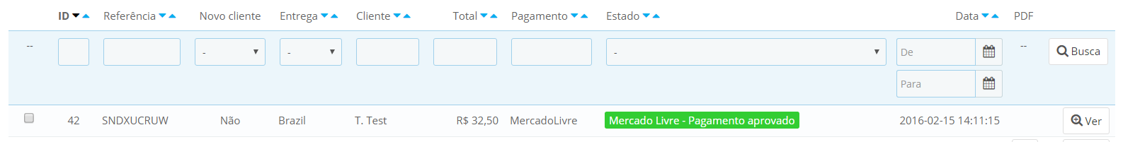

but the status is just partially modified. When i open the AdminOrders controller, the order is with the right status:

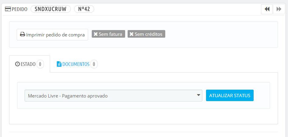

But when i click at the order to see its detailed informations, the status is not correctly saved:
I checked in the database, and the order history is not being saved in the order_history table, but the method changeIdOrderState() does not trow any error. What am I doing wrong?
