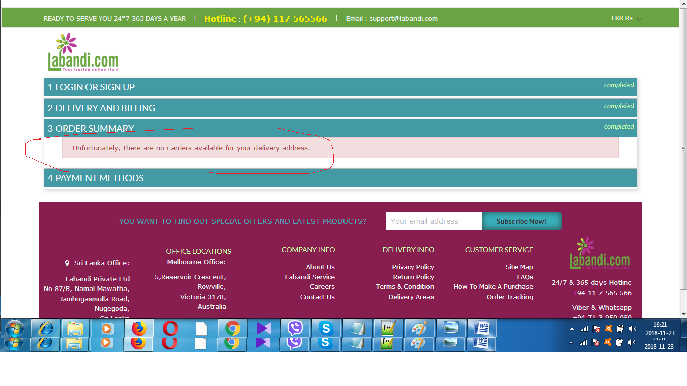

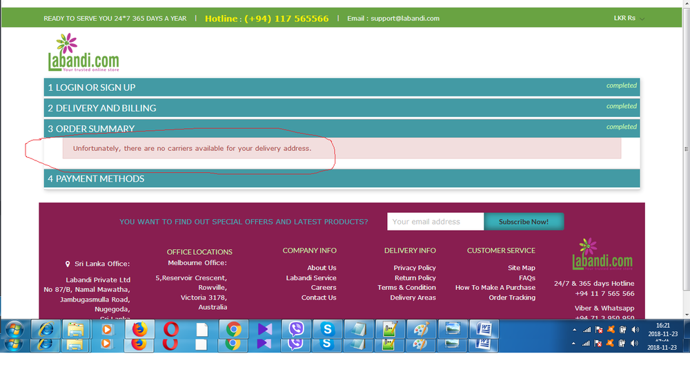

Hello,
I have to face the same problem, one country has many zones
error -  Unfortunately, there are no carriers available for your delivery address..please can you help me
my version PrestaShop 1.7.2
Edited by buddika (see edit history)

create new zone for a country.
then you can assign that zone at carrier level.
this is how we and others have gotten around 'most' shipping requirements.  also this was mentioned above by @tuk66
  • Like 1

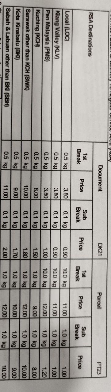

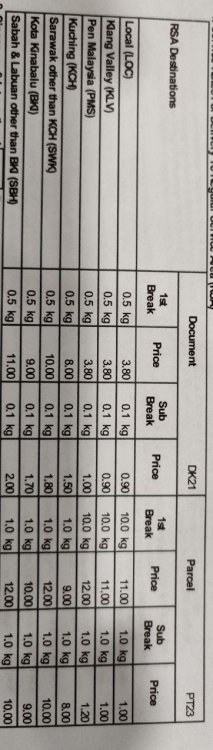

Ok.. reading up few posts, I think this is a design flaw by PS. In my country Malaysia the shipping fee is based on local state example i'm in the Peninsular Zone. So,
Shipping between Peninsular Malaysia (Zone 1) - > The price is MYR 7
Shipping to Sabah (Zone 2) -> The price is MYR 11
Shipping to Sarawak (Zone 3) -> The price is MYR 11
So, I created 3 Zones
Zone 1 -> which contains this state: Johor, Melaka, Selangor, Pahang, Kuala Lumpur, Putrajaya, Labuan, Penang, Kelantan, Terengganu, Perlis ...
Zone 2 -> which contains this state: Sabah
Zone 3 -> which contains this state: Sarawak
So, I assigned them perfectly.
Now, for the courier, I only select this 3 Zones and assign the price between 0kg to 10000kg with the fixed price above.
Next I made a sample purchase, in the address I put the state 'Melaka' and it's in Zone 1. But guess what, I cannot select courier there is no courier available to be selected. The reason is because.... Malaysia Zone is in Asia!!! and I also have to select Asia Zone in courier but selecting the Asia Zone I have to define the price for that Asia zone.. meaning that... whatever state I selected I got the delivery price from the Asia Zone not the Zone from Zone 1, Zone 2 or Zone 3.
So.... anyone have answer for this ?

I found out another way without using 3rd party module is to create different zone in states and define that price range in zone. This solved my issue.
  • Like 1
